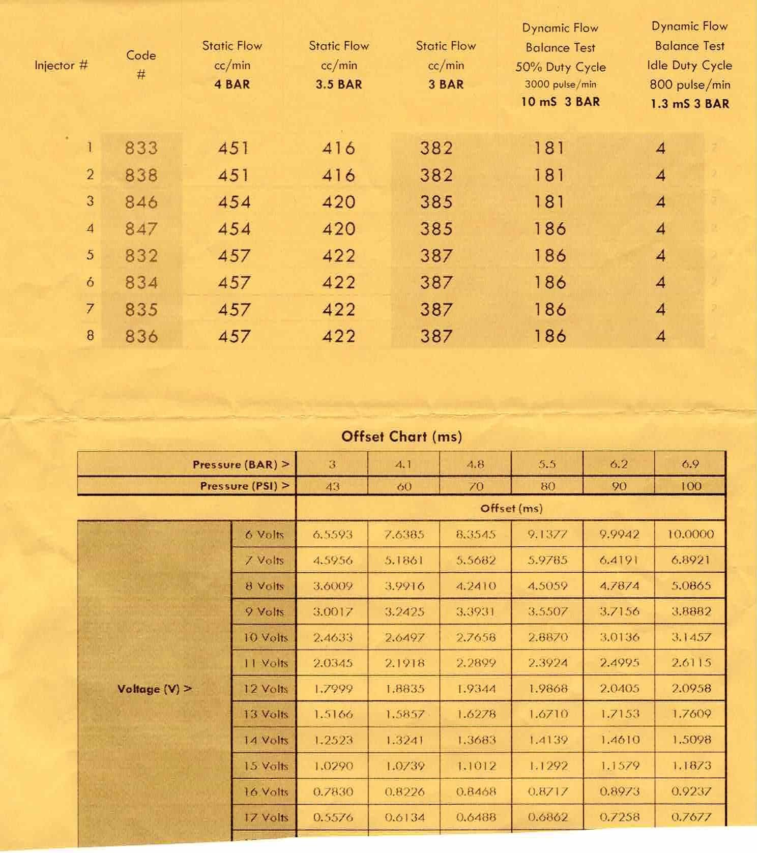

Well the injectors came a day early and he has included his "matched set" chart with it...which I didn't expect because the local guy who said my OEM injectors were fine also didn't do that and I just had to take is word. I've attached the document for your review to tell me what the science all means and if it's BS...or not.

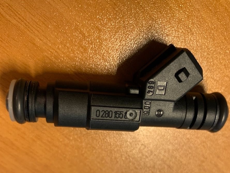

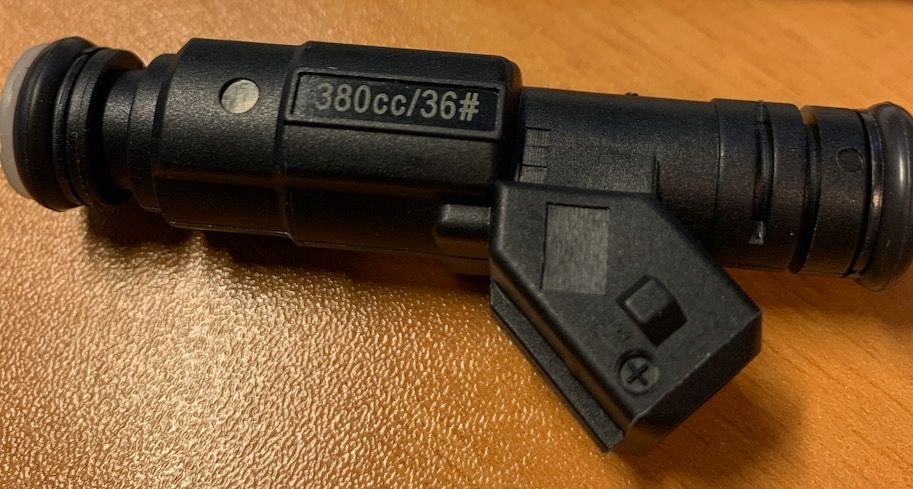

EDIT: numbers/info on injectors reads 0 280 1556(or 8) as well as along the top D 684 006. On the other side they state: 380cc/36#. Photos now attached.
EDIT #2: Ran the numbers at 3 bar. Avg 385.25cc with diff from avg. ranging from -.45% to +.85% with a total different between min. and max of 1.31%.
Thoughts on his data at different pressures and duty cycles?

Send them to Artic, as already said, before install. Let him prove them out.

IMO anyone could of laser marked the 380cc/36#.
But the molded in number side that does appear to be a Bosch symbol.

Im sure they are close, at static they will most likely be within 98%, its the part throttle settings where they may flow low or high. I bought 33, 34, 36 38 and 40 lb injectors from varios suppliers at one point trying to find a "match " to the oe injectors and although the 36 lbs were almost identical to the oes at static (100% flow, fully energized) they had different characteristics, flow rates at various rpms and settings that didnt match the oes. At that time I did NOT test the exact injectors you just purchased. Panther Geronimo, a member on here, was fixing a hurt 500 efi, melted a piston in hottest cylinder and sent me the injectors, although the injectors had some stuff carefully ground off them, a search on remaining numbers matched 36 lb Bosch automotive injectors, when I flow tested them against some average oe 500 injectors, they flowed a little different and did not match . When FU marine tuned this oin water, it needed some more fuel added to the tune in some ares and if I remember right some pulled out.
so my offer to you is at no charge I will flow and test 4 of them simultaneously against oems and give you the real world answer, it would be greta if they match close enough to be a viable injector to use as a replacement. I will also pay the return sh, etc and do it expediently. I see your near lake erie, would be a jaunt but I would even be willing to do it while you wait if you drive up.
