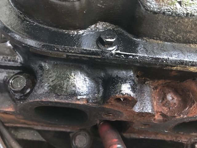

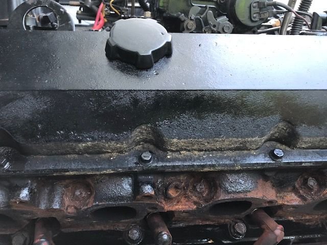

After receiving the engine, I can see black overspray all over the engine.
Mechanic had to remove ex manifolds to install in the hull. At this time I see all the rust/rot present. Head bolts are Shot.

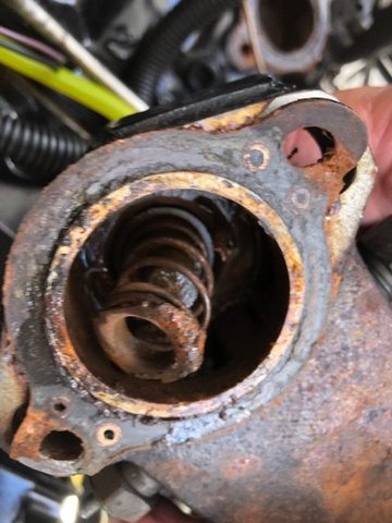

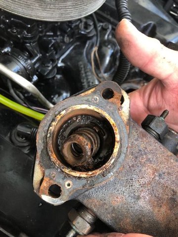

Check all hoses and everything is coming back clear. Removed the sea water pump and the impeller is perfect. Remove the thermostat housing and find this.
Removed the damaged thermostat and fired it back up.
