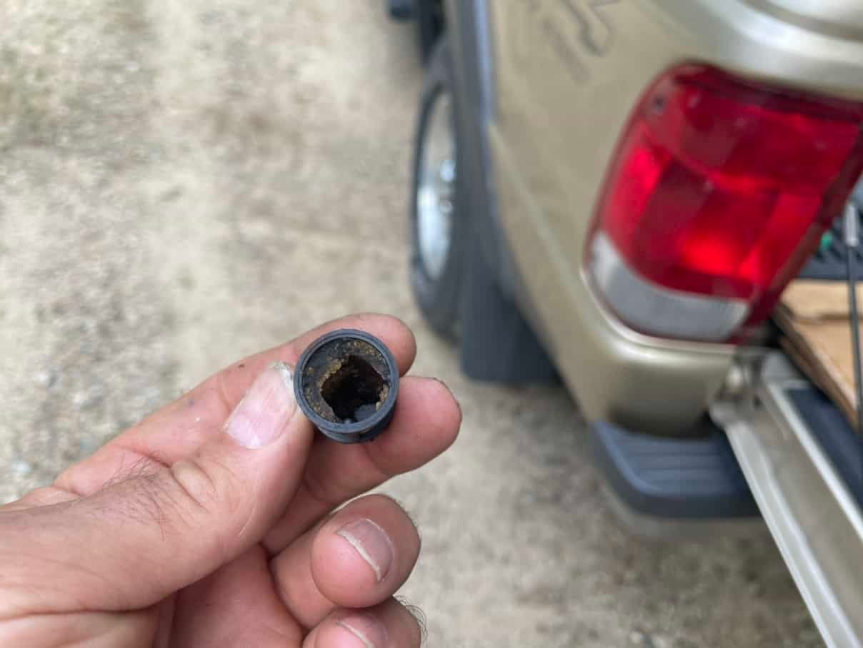

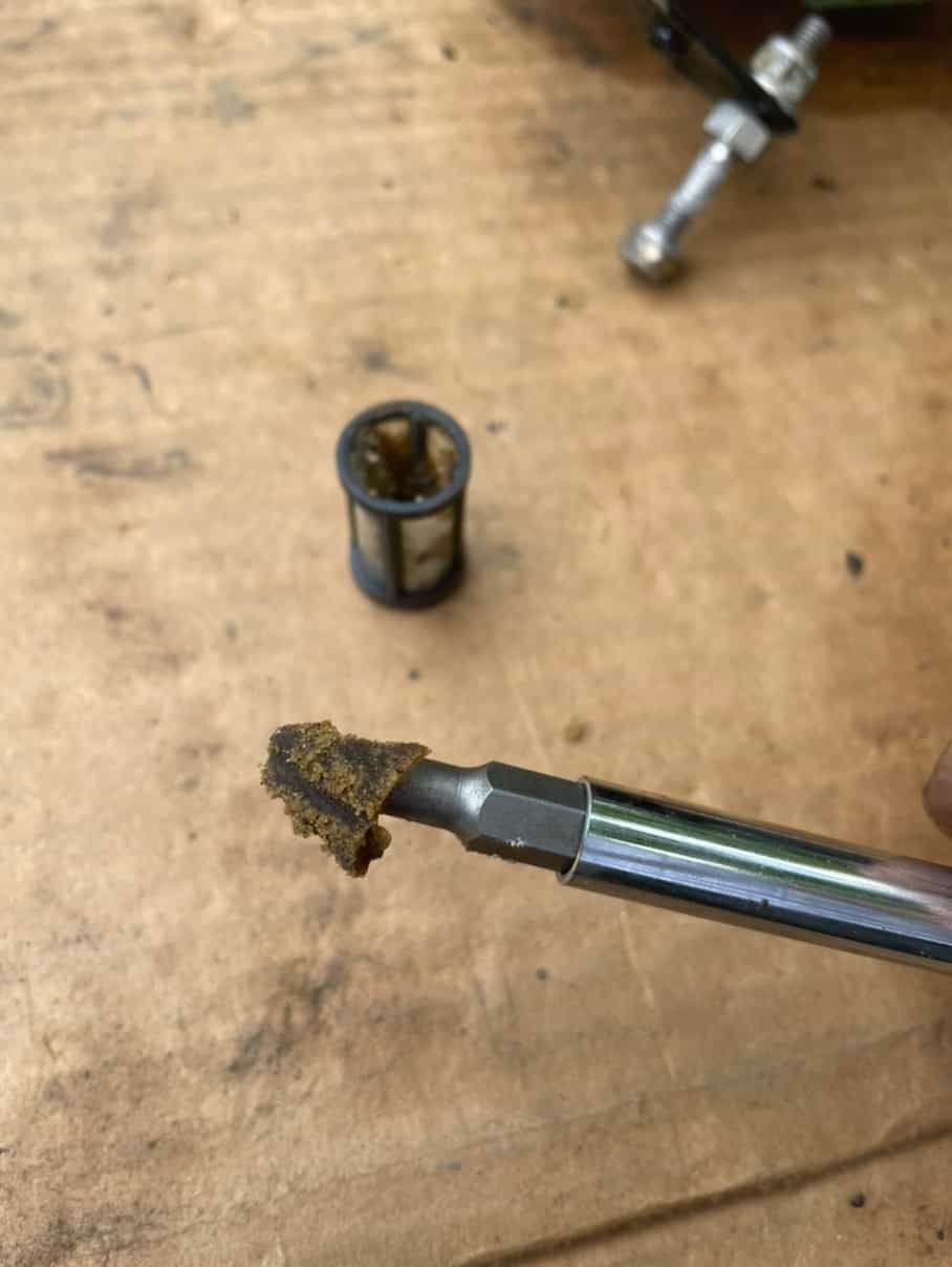

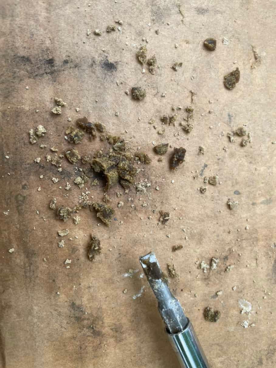

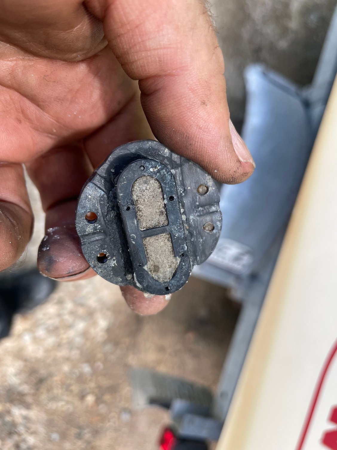

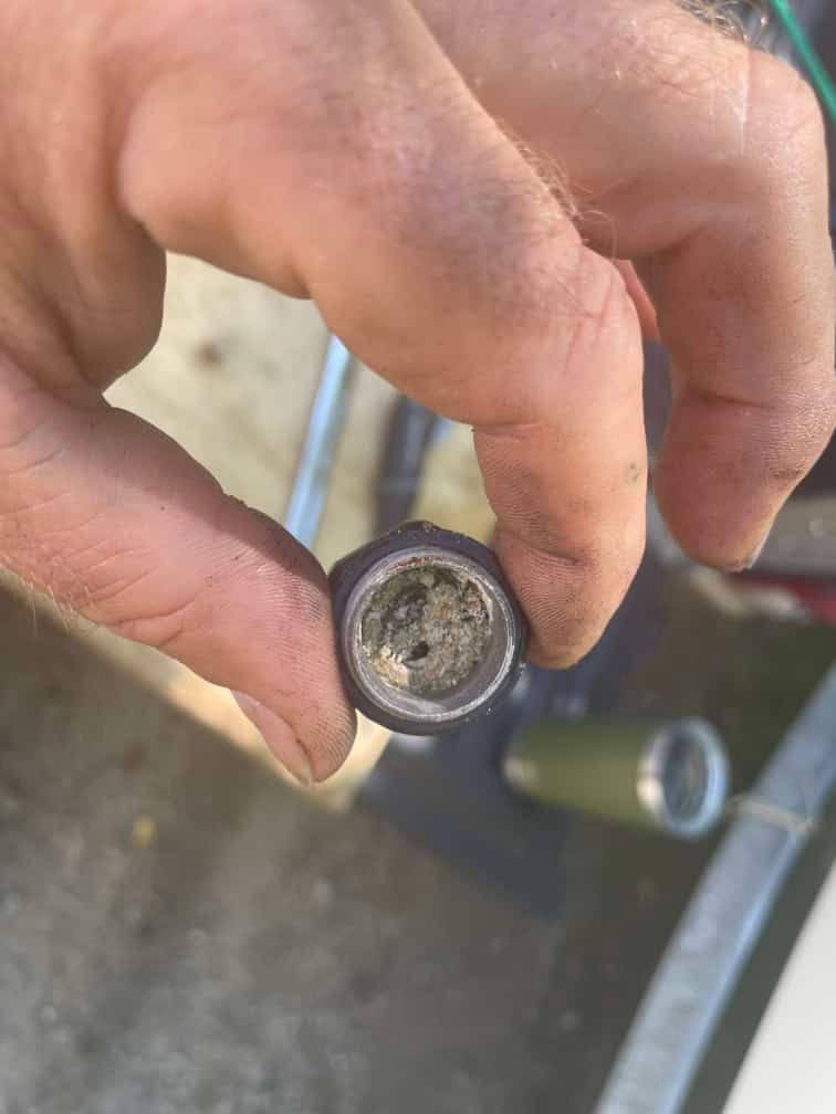

Here is some extreme examples from several boats this summer i worked on. Alot of other times, it is slighter amts, so looks like slight amt powder vs clumpy as shown below, lots of times just in the fuel bowls but get’s pulled into the metering blocks and etc. Basically, in places the fuel seems to evaporate from and leaves whatever additives don’t evaporate.

That's a pretty extreme example but you get the idea. It was yellow and brown and sticky. Handling them, my hands felt sticky like from sugar/honey and was hard to wash off. It was an effort to get them cleaned out.
The smell though... I've smelled plenty of bad fuel before but not with an organic "rotting feet" odor. Nasty. Thankfully, this was not what was in the tank. We drained and filled and replaced filters just to be safe.
