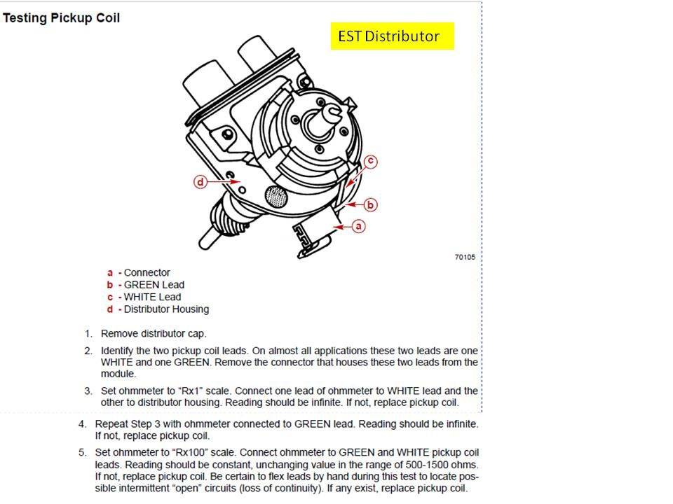

check these is you have them
F-2 Speedy is offline

thanks - verified power to square fuse at at starter, fuel pump does make a noise when I power it on.. Ill recheck fuses again- coil not grounded, its all plug and play.
I ran through the EST ignition tests and all passed perfectly, not a single issue there..
How on earth can a coil get so darn hot - im wondering if the ecu might be faulty. I even unplugged the new alternator to see if that made a difference..
