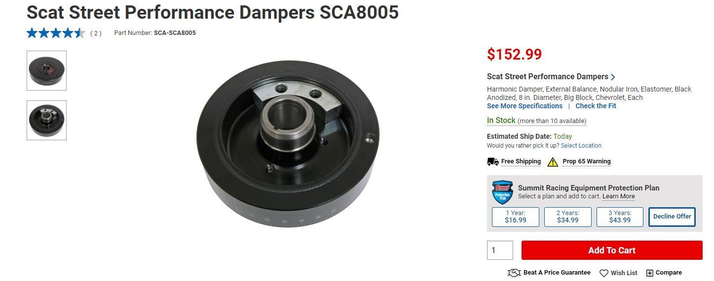

Both of my front crank seals are leaking so that is the main reason I would replace my harmonic balancers with updated ones plus when I hit the water next season (2025) the current ones will be 30 years old. As far as I can tell they still work fine however as mentioned above, there is only the TDC mark on the existing balancer and on the block I just have a pointer, no scale at all. Dyno guy made a mark at 33 degrees on the balancer with whiteout which is what I have been using. My engines were balanced including the flywheels and couplers. Do I buy an internally or externally balanced harmonic balancer? Is this purchase even based on the balancing of the engine or do all 454's require a particular balancer regardless?
I have attached a pic of a potential balancer from Summit. No idea if this is a good choice or not. Looking for some direction. Like OP, I was thinking $200 or so each.
Thanks for your help

On internal vs. external, it is referring to the original design. Externally balanced engines will have counterweight(s) on the balancer and flywheel. The silver "quarter-moon" shape in the one pictured is an example.
So, you'll need to replace with the style you currently have.

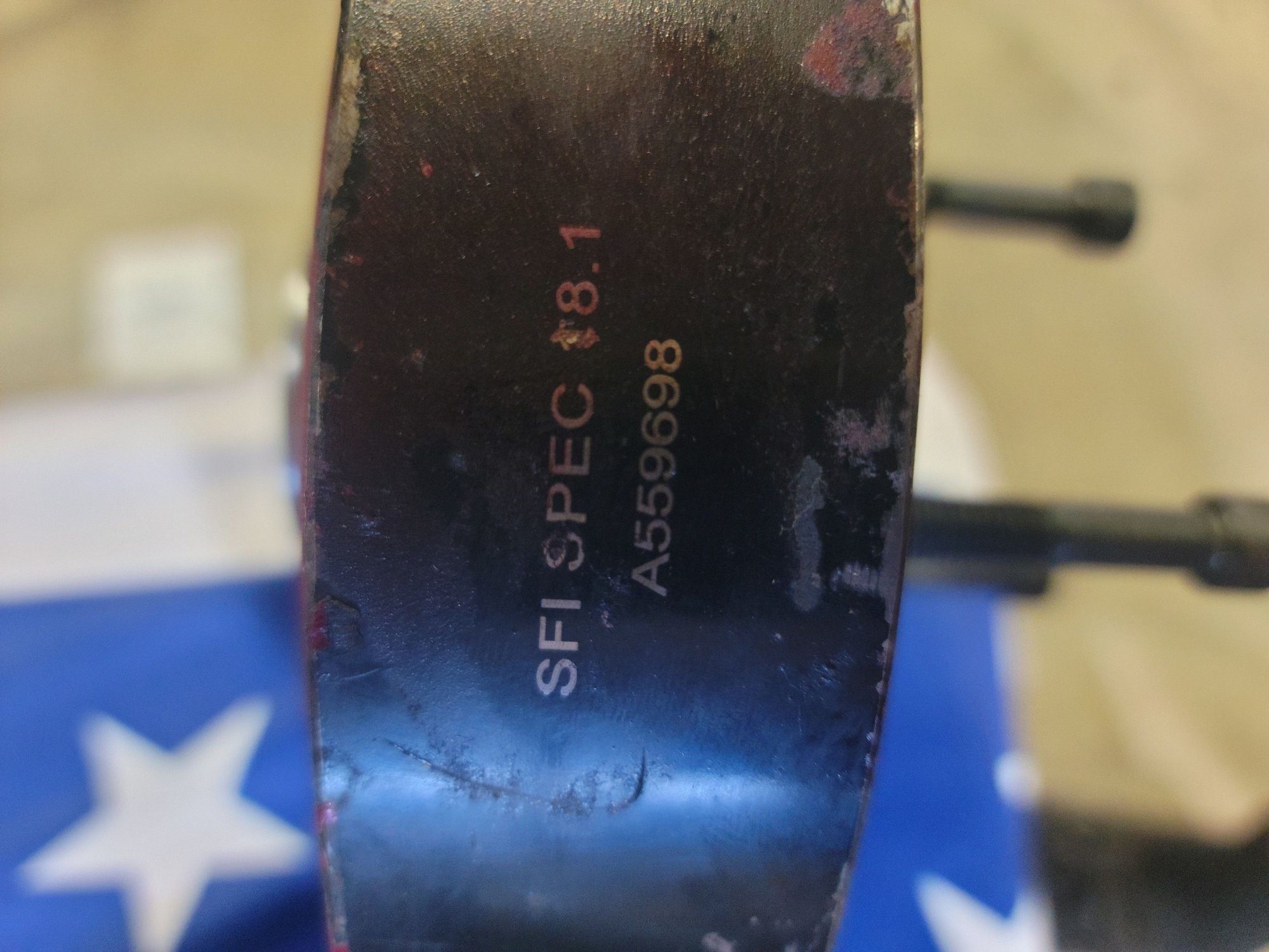

I just pulled one of mine and it probably should have been replaced during the rebuild. This is the original one to the engine and it has about 850 hrs on it.
I don't know if there is any real benefit in going much more than OEM stock for me. I do want the degree marks on the new ones though.

OEM is fine for what you're doing. A Pioneer balancer (externally balanced) and some timing tape for an 8-inch wheel will be more than adequate (paint over the timing tape with a clear nail polish... will last a long time). For a little more, Professional Products has them degreed already and can be setup for internal or external balancing (but they're chinesium).
https://www.summitracing.com/search/...nic%20balancer
I'd be a little worried about that rust though... what's up with that? Any water in the engine?
