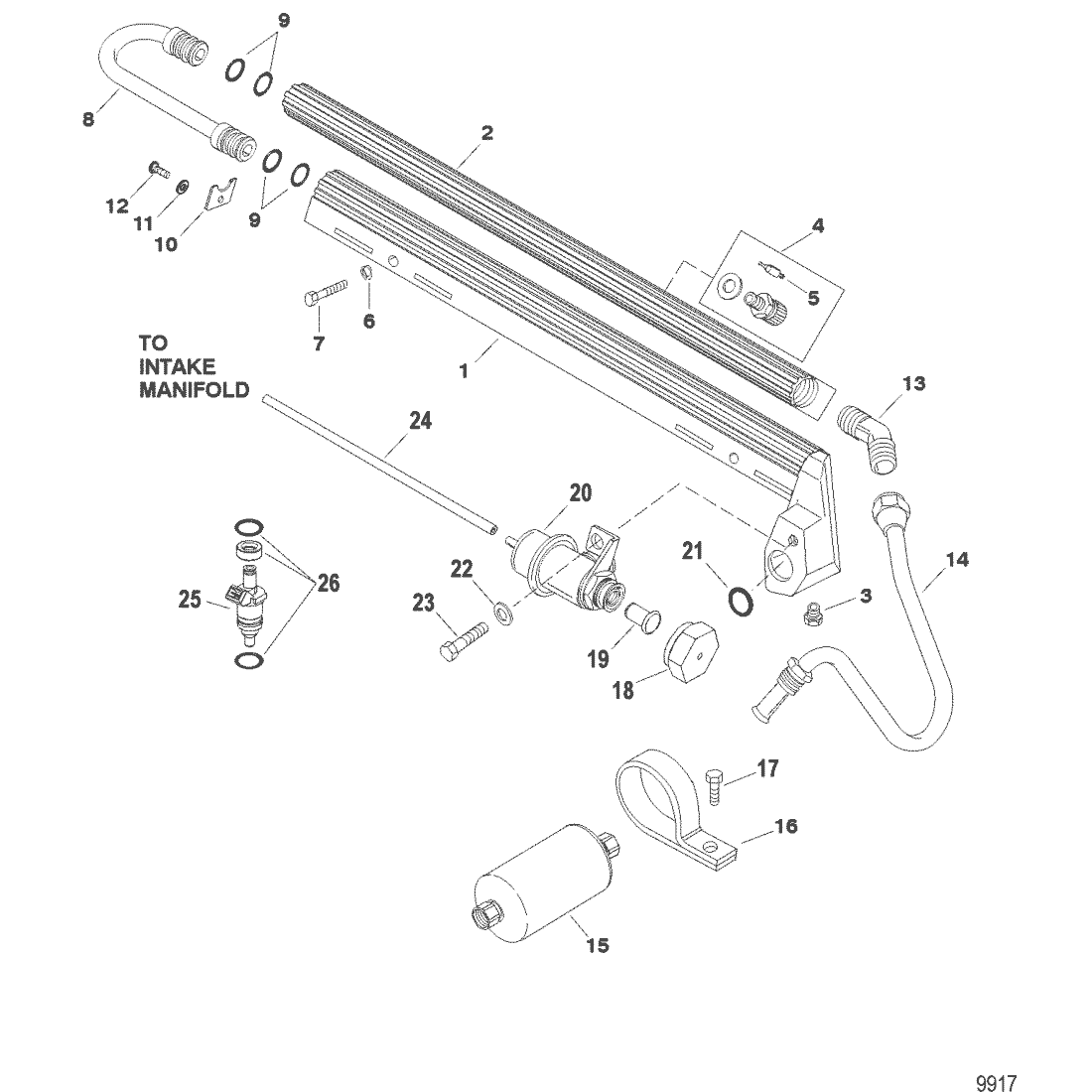

#4 is the schrader valve on your fuel rail for using a fuel psi checker. You can rent for free auto part stores like Autozone.
