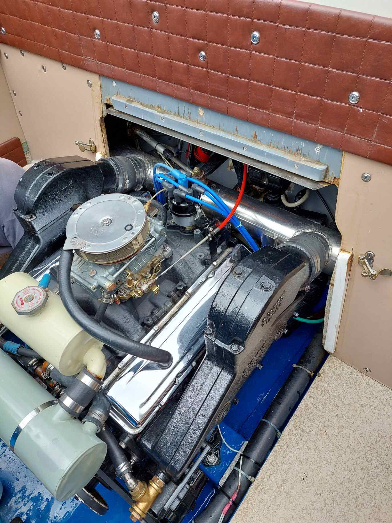

Here is the 350 Volvo 280.
Drive has about 20k hours on it. Mostly all original. Well maintained.
