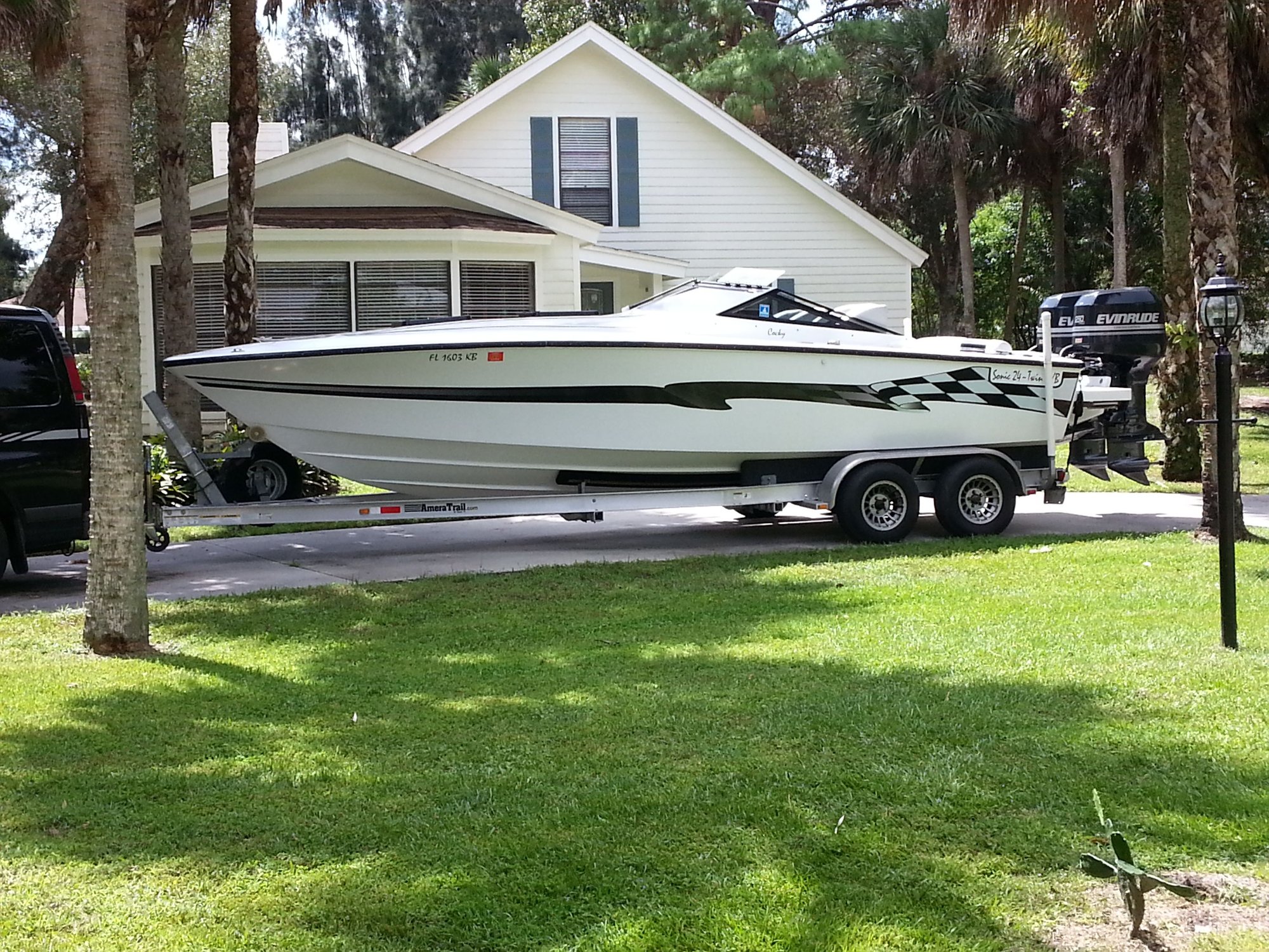

My latest project is a ‘87 Checkmate 25’ Convincor that I converted from single IO to twin OB.
My first two were 24’ Sonic which had 8’ beams.
The Convincor is only 7’6” and runs WAY different!
VERY sensitive to trim, tabs, weight etc.
I built a galley in the cuddy and mounted a 15 gl water bladder in the anchor locker.
Went as big as I could, as far forward as I could to get as much effect from its 125 lb as I could.
HUGE positive improvement on handling!
Also had a new 92 gl fuel tank built so changed C of G on this hull about as much as possible!
Checkmate offered this as twin OB but w/motors mounted to transom.
Mine are on a 20” bracket w/Jack plates which add another 6” of setback!
We have been using the thing as a cabin cruiser this season but am about to head to the local pond w/my 6 sets of wheels to start high speed testing.
So knowing w/adjusting water level, etc, I can effect C of G, what should my target be?

I’ve done quite a bit w/rebalancing trailers to get proper tongue weight which is a great example of how much I have shifted weight in the hull.
Although I never checked tongue weight as purchased it did tow perfect at 80 mph on its way home.
Once the power conversion was complete it was scary to tow and swayed terrible!
I weighed the tongue at that point and was only 135 lbs!
Far from the targeted 10% of gross, loaded weight which is 4500 lbs.
Had to move hull as far forward as I could which was almost 2’ and got tongue weight to 450 and now tows great.

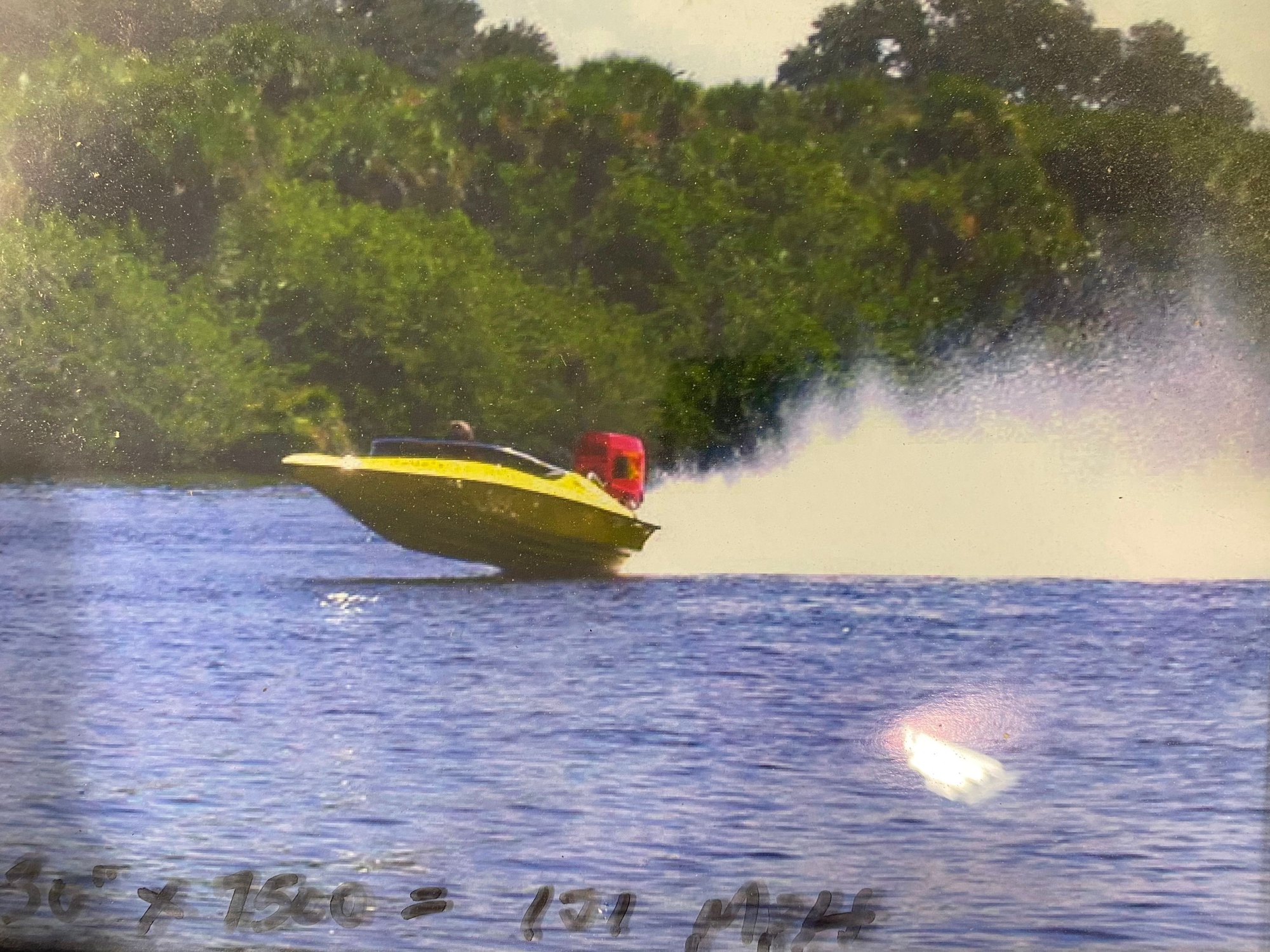

As to weight shift in small boats, I designed/built and raced outboard hydroplanes for 9 yrs so I totally get that.
I firmly believe I am as good as I am on trim buttons because I spent 9 yrs w/my ass being the trim buttons 😂
Also spent many yrs playing w/fast single OB hulls.
https://cimg2.ibsrv.net/gimg/www.off...4c60fad8e.jpeg
https://cimg3.ibsrv.net/gimg/www.off...467647c74.jpeg
https://cimg4.ibsrv.net/gimg/www.off...13484fa3d.jpeg

Heres a shot of my first Sonic.
I dissected that shot a million times!
Took a straight and drew lines for the keel where it was invisible in the spray and another along the transom to estimate wetted area.
That boat had a round keel so not a pad bottom vee.
I calculated the last 3’ of keel and 6” on both sides were the only thing wet.
Perfect attitude (for an OB), perfect trim and the perfect, long flat rooster tail!

Twin O/B Sonic 09-16-2022 11:33 AM
Unfortunately the scuzz was in the gel when I bought it it and never got it out.
I painted the second one.
