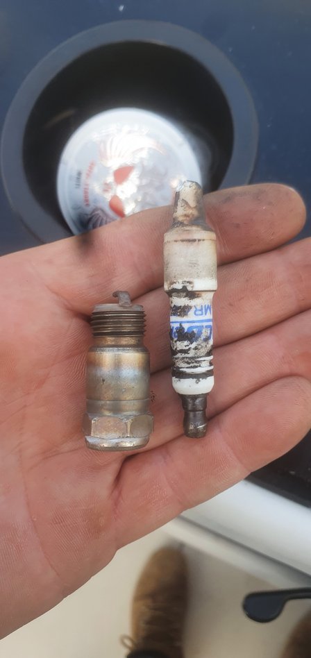

After i replied to this thread about bbc intakes poor fuel distribution, i went for a ride and boom. Cyl 3 spark plug exploded. Luckily only at 3500rpm cruising speed. Hopefully it was caused by loose spark plug
maybe it’s the angle of the pic, but that ground strap looks like it has rust on it. I’ve seen plugs come apart like that from water and detonation
