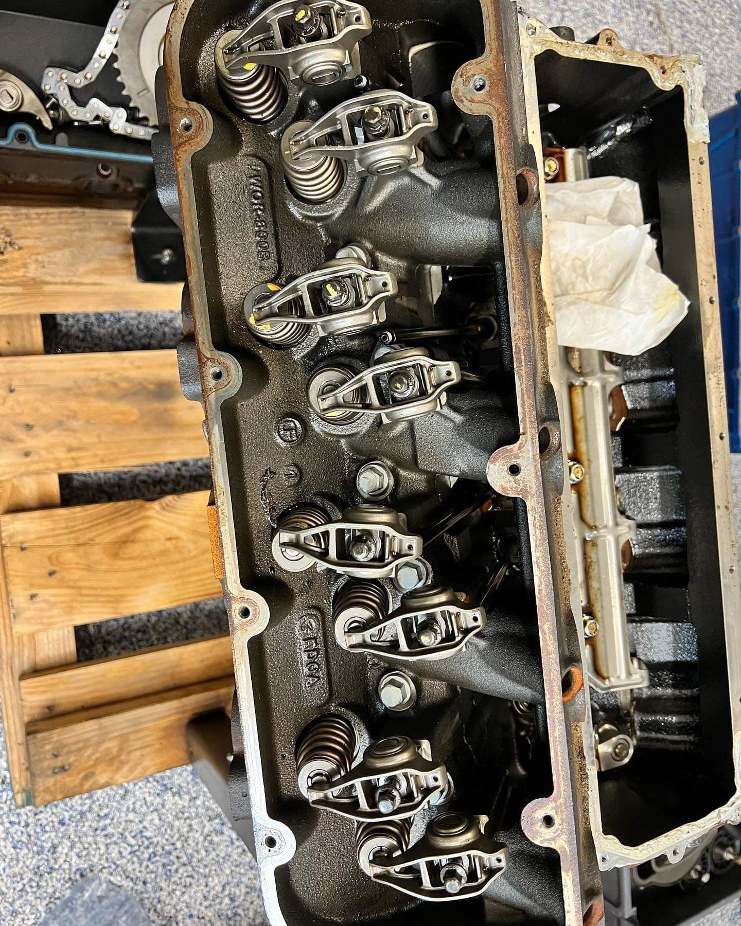

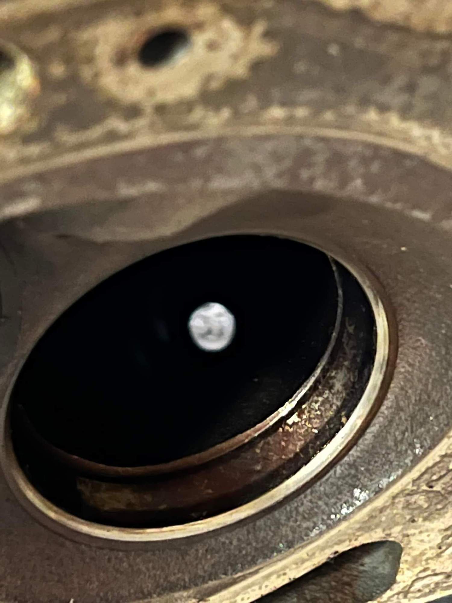

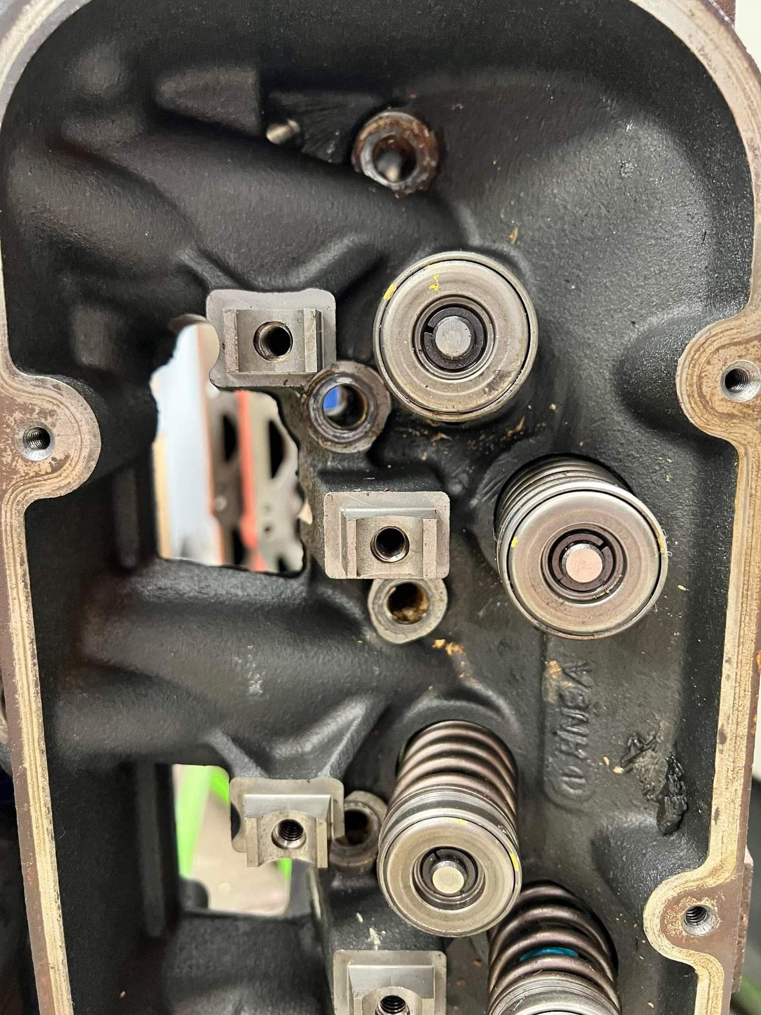

Dragracer_Art 11-01-2022 12:46 PM
8 Attachment(s)
Originally Posted by Cerberus66 (Post 4849454)
One more thing. WORLD does not cast these. They did not design this. PSI still uses the external casting box for these motors and if you call World, they will tell you they do not manufacture or design anything you are seeing. Its simply an external casting box that still has those markings.
Is there any way to determine which blocks are which from an external "junkyard" viewpoint ?
Ive found a few rebuildable cores online and would prefer the "R" block and better heads if I can narrow down some of the visible details.
Are the head-mounted injectors exclusive to the trunnion style rockers and shallow valve angles ? or is that prototype-only stuff ?
I also see the bolt-on intake valley pan... is that exclusive to the better block ? or do they all look similar ?
Thanks in advance... just trying to nail down a good core to play with.
Cerberus66 11-01-2022 01:05 PM
The block casting number is 80000795R
PSI made three different valley pans, three different intakes th elates of which has orings around the ports.
ALL the LS Style heads have injector in head
Cerberus66 11-01-2022 01:09 PM
the picks you show should have Kellogg Heat induction forged cranks. Scat manufactured prostock rods. Some also have forged pistons. Dished pistons are 9.1 Flat tops are 10.1. All the rods are bushed.
Cerberus66 11-01-2022 01:10 PM
The injectors with plastic and red are NG
The others are gasoline.
The natural gas motors always come with 10.1 compression pistons.
