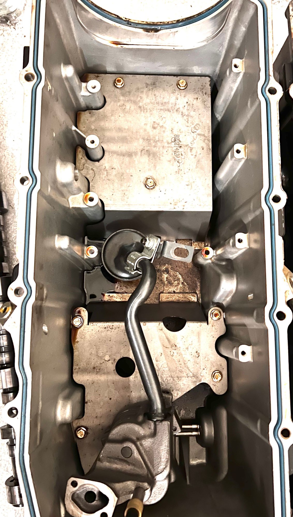

Those appear to be lease return engines. My bet is they have next to no hours, crass hatch is crystal clear. If they have flat top pistons they are 10:1, the Rods were built by SCAT they are prostock I beams. the rod caps are cracked or they could be machined, they transitioned to cracked ones. They are bronze bushed with small ends tapered.
Fuel injectors are Bosch 89lb high imp injectors. very valuable and are sourced from the BMW M series platform.
The oil pan has two different baffles, they do fit any mercruiser installation.

https://cimg3.ibsrv.net/gimg/www.off...78ade57fa.jpeg
your oil pans will look like this.
