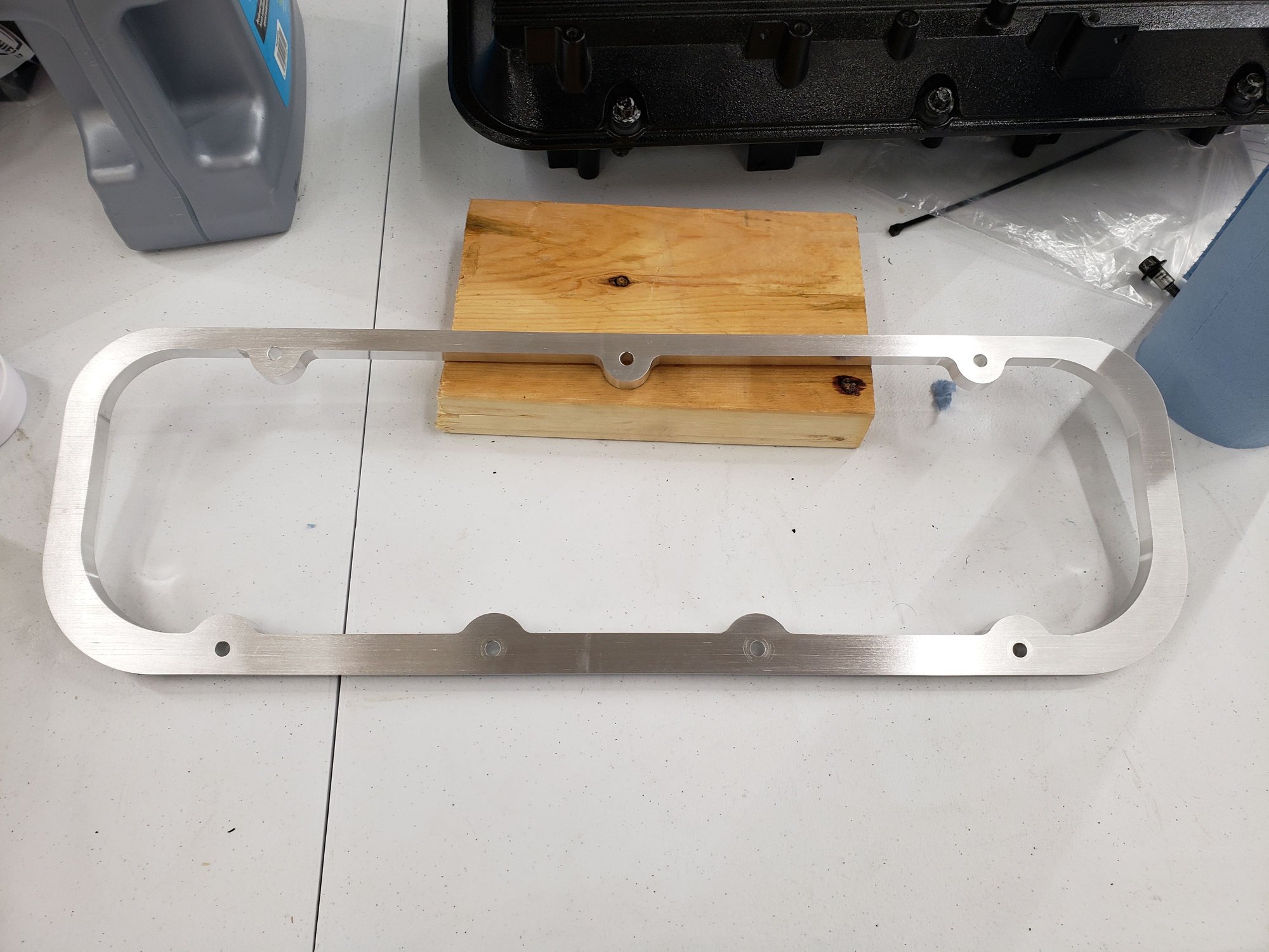

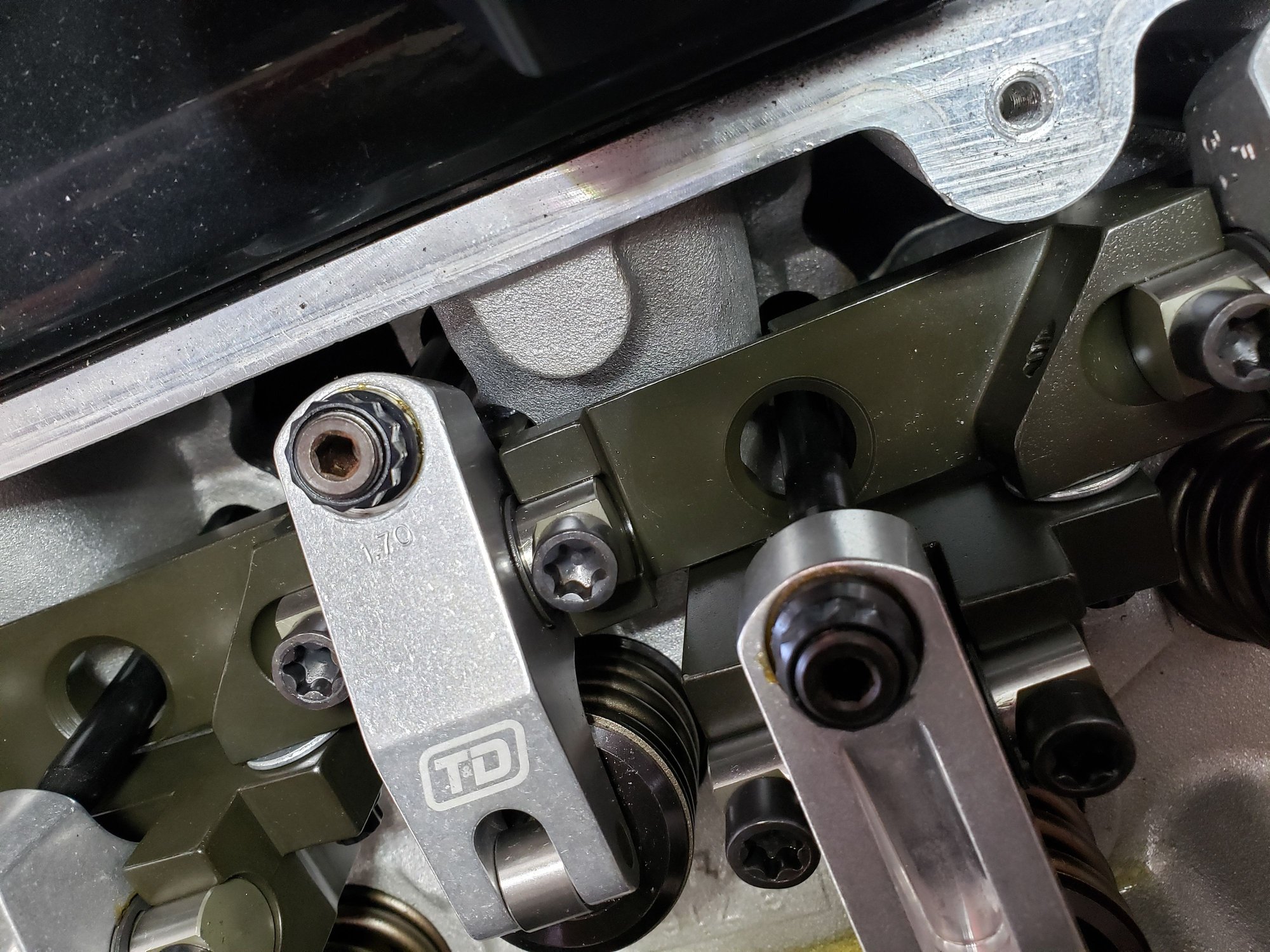

I agree with Keith's advice. I ran the Raylar bolt on stainless rockers in the past and they worked great. They fit under the stock valve cover which is sure easy, as there aren't any aftermarket covers available for this engine.
If you do want to go adjustable you can, I did with a set of T&D rockers on Raylar heads. I had to use a 1/2" Medice Mfg spacer to make it clear the stock valve cover. The factory exhaust cleared just fine after the spacer install.

That looks like a nice set up.
What did you do with the coil packs? Are the plug wires long enough?
87MirageIntruder 11-14-2022 01:16 PM
The plug wires were plenty long, coil packs in stock location. With the Whipple the plate for the PCM gets moved a little anyway and it all worked. You can see the cover spacers in this picture. This is a Raylar 800HP package except for the upgraded rockers.
