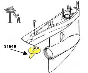

I do NOT know if this is the answer to your issue, but it may be an option.
https://www.boatzincs.com/mercruiser-zinc
Attachment 577451
If you scroll down through the zincs that mount to the cavitation plate, above/behind the prop, you will notice that they have options for different ones that a fin to them. I have seen those installed slightly off from directly aligned with the drive, in an angle that will counter the prop torque.
Again, you will need to talk to an expert to see if this is something you can/should try.
Attachment 577451
thanks maybe that will help. I’ll look into it.
