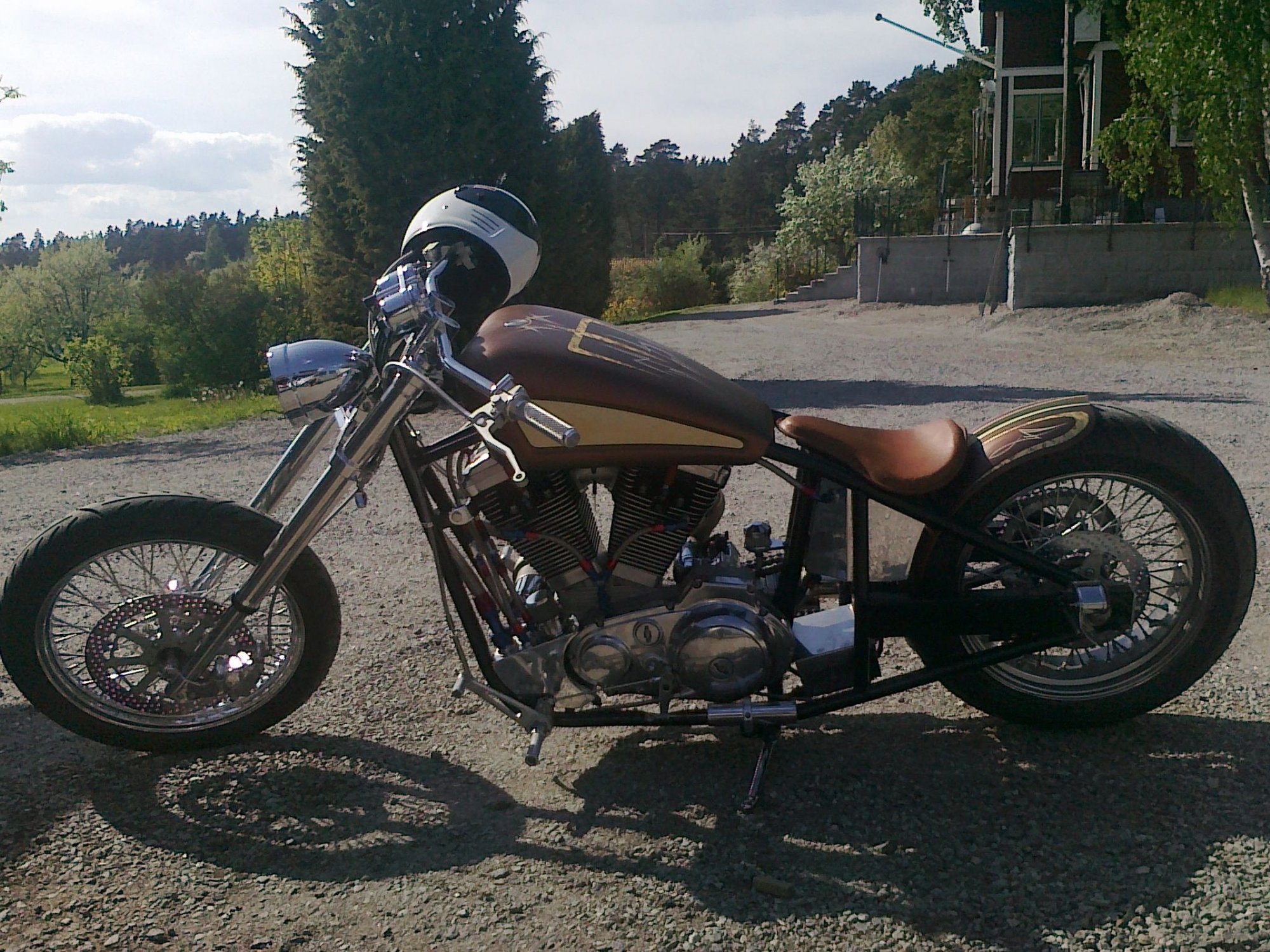

I got a bike with titanium rods in it. The rods where made in Russia in 98 I think. The engine was originally built for drag race but now it just have a great pension in one of my bike builds.
