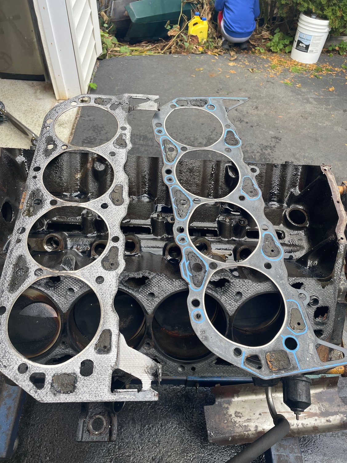

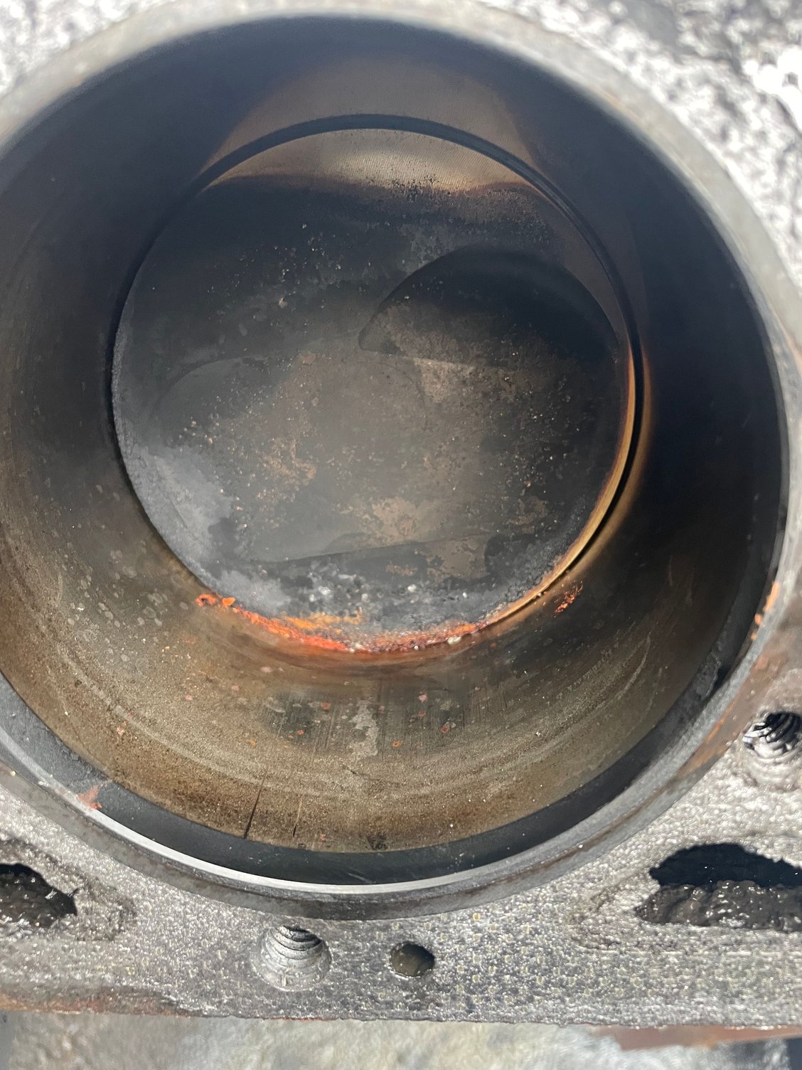

So before going through all the trouble of swapping intakes, how bad is the stock MPI? Are they really as restrictive has I have been told, is it really worth swapping it out? Again im not looking to make a 75mph boat here I just want a fun lake boat that works well and decently performs. Best I ever saw out of this thing was 62mph once, it would normally run around 58-60 at WOT and cruise around 38mph at 3,500rpm. I knew something wasn't right as it began dropping off MPH was decently and when I opened it I found the below:
Parts suck to get now so I don't want to make this more complicated than it needs to be, I want my boat back in the water by Memorial day, engine was dropped off to the machine shop Friday. It was running on a MEFI-1 which is believe is garbage so swapping to holley is a MUST. I was thinking of going dry exhaust and a HOT cam but thats all out the window, I just want it to sound good, fire every time and enjoy being on the water!

Looks like someone replaced one head gasket when they shoulda done both.
