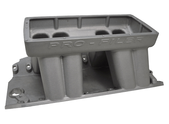

The profiler is the out of the box hp king though.
The runners were pretty thin to weld bungs to when I tried it, a long time ago.
