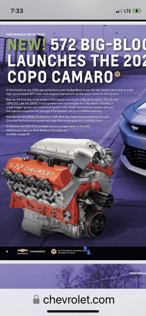

Maybe something good in near future ? Skimming the GMPP catalog and reading about the COPO 572, it shows/refers to it’s intake as a Holley HiRam.
#1: No listing that i can find for it yet in that catalog nor Holley’s. Anyone find one ?
#2 : The Copo 572 is a tall deck motor, therefore it’s intake will be for a tall deck. Maybe they’ll make on in near future for standard deck ? Who knows,
but it’s something to kerp sn eye out for.

Cool, reading this thread I was racking my brain trying to think of front feeder efi ram for a BBC. No other I know of

In my head for many years with the Dart Tunnel Ram making so much power on so many different cid bbc’s, would be great if someone could make a frt mount tbody top for it.
Rookie 12-04-2022 07:22 PM
I read in another article that GM had to design a custom intake to accept the Holley LS7 HI-RAM upper lid. The base intake manifold is GM and the upper is Holley. I've been searching for that lower for a year.
SB 12-04-2022 07:36 PM
You could 3d print a top for the Dart tunnel ram ? :) :wink :cough :wink

The dart is kind of porter special, not the best ootb. Maybe it matches up to the smaller heads well.
