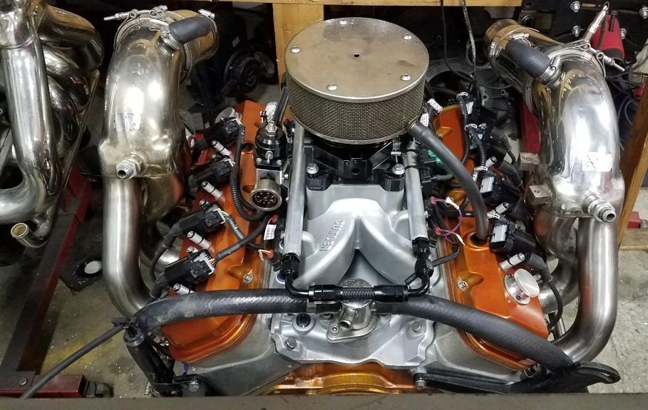

Originally Posted by Joeyboost
What Holley multi-port injection system are you running on the 7.4's?
Holley HP with old Cutler multi-port intakes, D585 coil CNP.
What water neck is that? I would like to update the stock MPI water neck currently on the boat.
Stainless Marine that came with a crossover. I made a 1/4" aluminum adapter plate so I could "clock" the thermostat housing properly. More visible in this pic.
