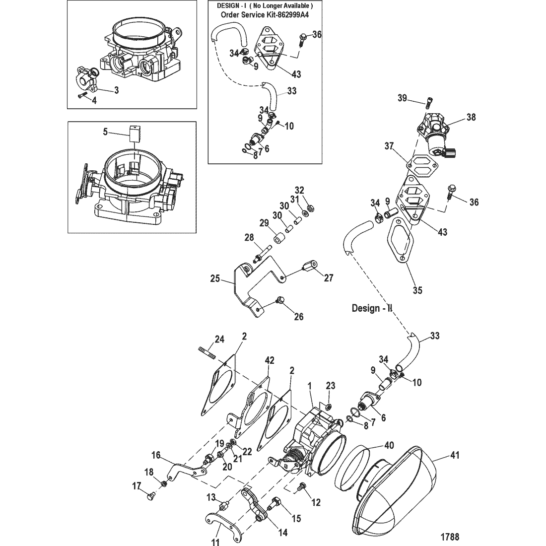

This your iac ?
https://cimg0.ibsrv.net/gimg/www.off...a1f7bd9b9b.gif
MIAMI/BAJA 12-23-2022 07:33 PM
yes
[QUOTE=SB;4854170]This your iac ? yes.. thats the iac.
MIAMI/BAJA 12-23-2022 07:36 PM
yes!
i m looking online, some iac have the pin, and some not.
mine is original mercruiser because it has the part number stamped. this one is supposed to have the pin and the spring... and it is not in the valve.!

Hi, thanks for your answer, yes definitely I'm replacing the whole IAC, i just got the new one OEM. my concern is where inside of the engine is the pin and the spring missing from the one is broken...? if i remove the little manifold ( number 43 on the diagram) do you think i going to be able to find the little parts?? (Pin and spring)

going back to the parts missing... i ll remove the little manifold (number 43 on the diagram) to see if i can get the spring and the pintle.
