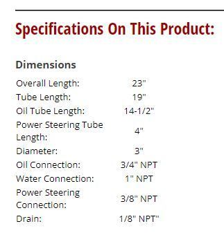

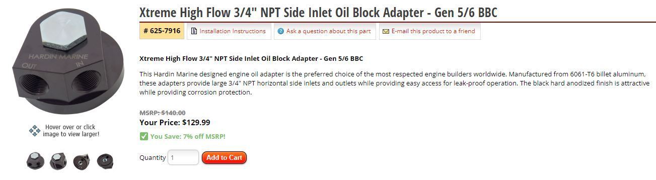

PQ290Enticer 02-01-2023 04:26 AM
So this is the cooler I purchased as a kit. Whatever the "real" oil connections are, doesn't matter. ALL of my connectors are the same size. Stock remote oil filter block, cooler, and the Hardin block mounted adapter.
