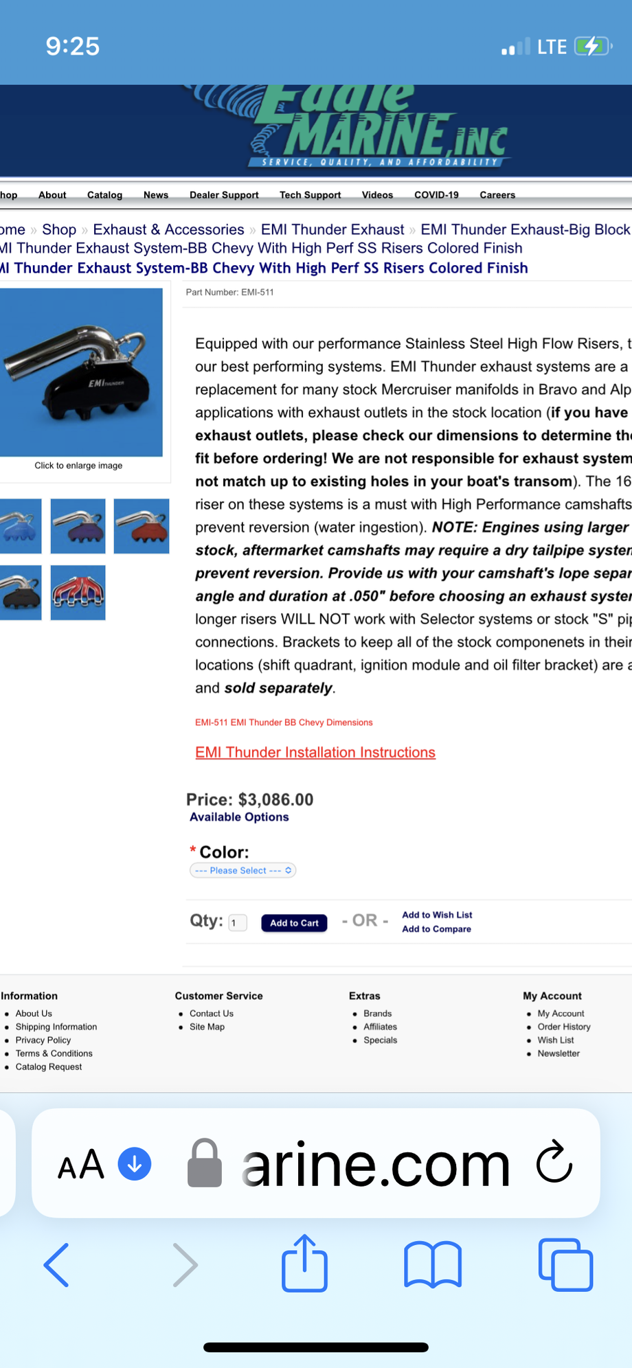

Hey guys, I have a question, I am trying to make my engine rebuild as speedy as possible and I know these days that's a hard task. So my 502 is at the machine shop it suffered a bag head gasket last season and I trying to plan how aggressive I can get with the rebuild without breaking the budget or creating something that will not be enjoyable and become more of a hassle.
The boat is a 1996 Baja 252, its a cookie cutter boat and I currently have EMI Thunder manifolds and cast risers, I want to replace the cast risers with SS mandrel bent risers and potentially delete the silent choice along with the Y-pipe. I spoke with Eddie Marine and they are telling me before I can order them I need to do a custom mock up with PVC pipe. SO I have NO motor in the boat and it is shrink wrapped for winter so now I cant order. My Transom and exhaust is STOCK and not modified, why would they not have a replacement. If I were to rebuy the entire kit your telling me I would have to do a mock up before hand??????
I'm trying to gather all my parts so as soon as spring arrives and the motor is back I can start assembling to be ready for May. Only positive thing he did say is they can add O2 sensor bungs because Im running Holley HP injection on the boat.
Sorry for the rant but does this make sense? If it does then I will be getting a plastic mock up block from Jegs and wasting $500 so I can get their measurements ASAP.

I never looked at the complete system as the boat already had them when I bought it and was just looking at risers. Sure poses an issue being their is no motor in the boat at the moment to measure off of. My question is if the cast riser on their system lines up perfectly why would the stainless riser be different? Now do I run the risk it doesn't line up or do I buy a plastic block to get in the boat for mockup for $500 to save me time?
I was not suggesting the full system.
I wouldn’t think your manifold is any different than that one.
I’m with you. What are we missing ? The literature shown says what we think.
Was there a communication issue between you and the phone person ?
Are your tailpipes in non Bravo position ?
SB is offline
