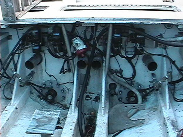

had always hoped you would get two new 300-400 HP diesels installed and have 20 years of trouble
free boating. Imagine if one week after you took this picture you installed the new diesels and have
been blasting around Florida ever since? Whatever happens with this new engine saga I wish you
the best.
