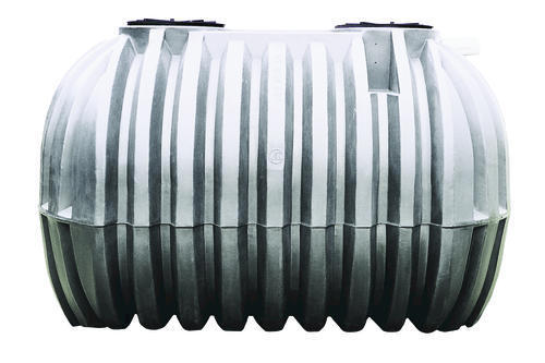

So Im buying 2 industrial grade silencers with 8" inlet/outlet to mount on outside wall of new dyno room for normal dynoing. Im also burying a 1500 gallon plastic tank that water from dyno brake is going to gravity drain into.Going to add extensions to top of both vents on that tank and when I dyno wet exhaust there will be a second set of exhaust holes thru the wall, will expand tailpipes from 4" to 8" pvc with 90s turning into the risers on tank. IF there isnt a clear expansion/size change on a tailpipe from its 4" or 5" and its extended with SAME diameter pipe, youve now created athe wolrds longest collector, Smitty
