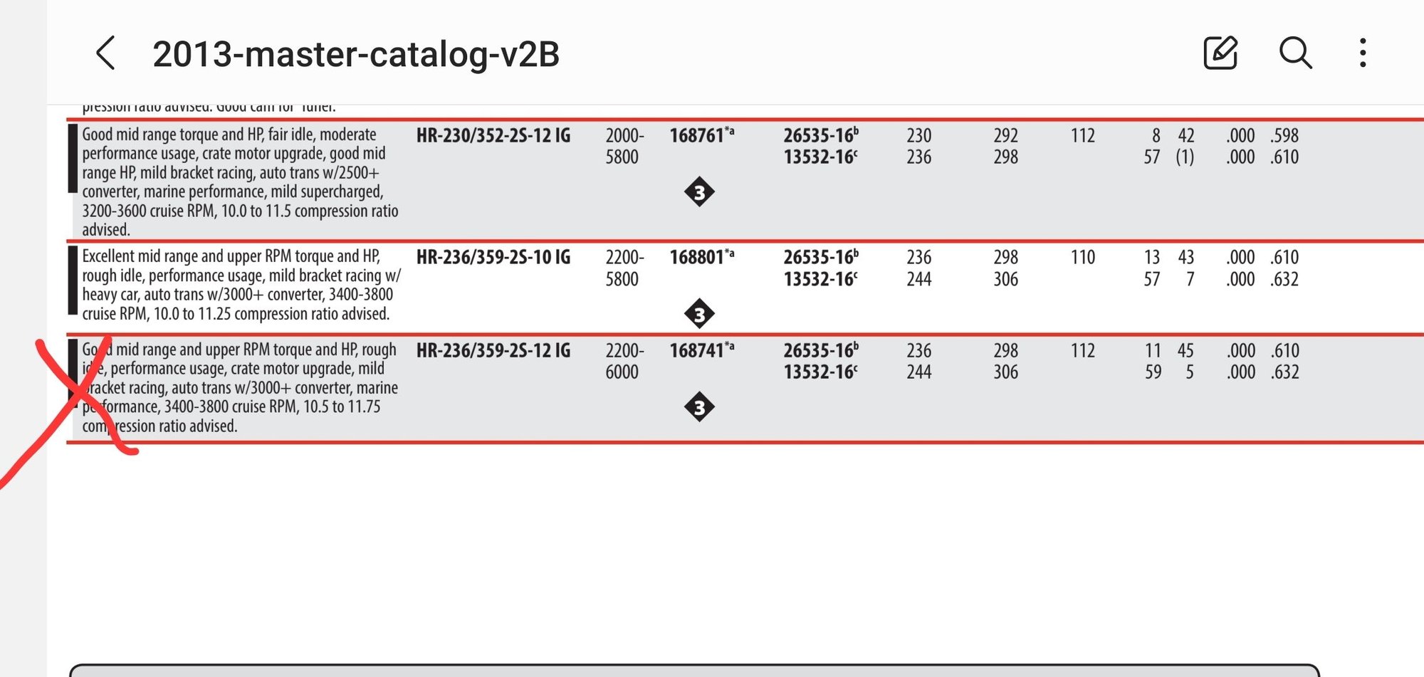

My last 502 made 905hp/915 lbs at 5k. With emi exhaust and silent choice. I am happy with those numbers.
HPJunkie is offline
Old 03-14-2023 | 12:48 PM
Joined: Oct 2001
Posts: 583
From: Stillman Valley Ill
Crane "741"
that was a beast
