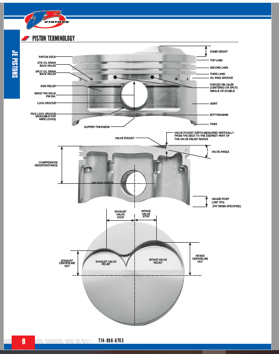

If I were to start my fantasy engine, ideally, I'd have 4.53" bore pistons with 1.29-1.30" CH, which is not on their list of options. Did I read somewhere here on OSO that JE will make pistons to custom specs? Being a toolmaker of some skill, it doesn't seem to me that it would be any real feat to machine wrist pin holes .020" from a stock dimensions.

And yes for the JE pistons....I was close to ordering custom pistons from them on my current engine...at the time it didn't really add any cost and back then(pre covid horsesh!t) they were only a couple weeks out so not bad at all I didn't think.

I see that now, exploring JE's website. This solves the math. Now, I just need to confirm... Stroke/rod/CH stackup should total short of the actual deck height, correct? Is that the "deck clearance" the diagram shows?

Yes, Im building a 4.375/4.600 tall deck right now for a non boating application and its as simple as getting pistons with right Ch. If I was going to put a 4.25 stroke tall deck together, Id probably go 6.800 rod length to get some of the mass out of the piston, Smitty
Smitty,
So....
10.200" tall deck
4.375" Stroke
6.700" Rods
4.53" bore, 1.310" CH Pistons
Rod/stroke ratio of 1.53:1, and maximum rod angle of just over 18deg.
Assuming JE's numbers relate directly to piston diameter, this would put the bore of the block at 4.535", making for 565ci. Perfect.
