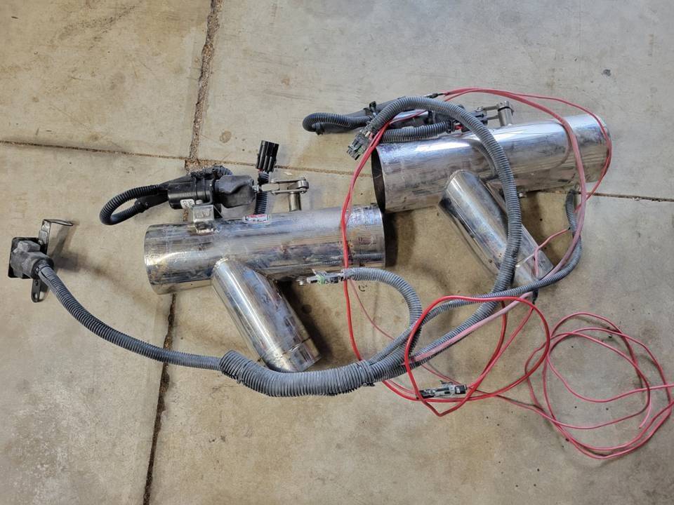

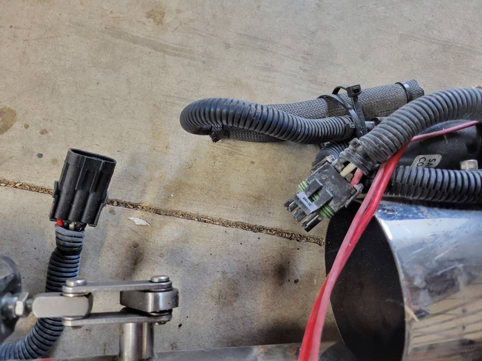

Hello, so I知 new to the forum! And I知 hoping to find some help with these diverters I bought off eBay! They are 4 wire they do not match the stock corsa diverters, has anyone wired these?
I contacted the seller and they are clueless on parts they sold! They gave me half my money back and now I知 trying to figure them out!

I have the harness and everything just on the diverters I bought don稚 have the connectors on them and the wire color don稚 match!

I'll look at mine later and post a pic

Correction - The older ones were 4 wire, the new are 3 wire
Mine is a 3 wire and it uses two 12V feeds and a ground. One from the Battery with fuse, the other comes from a switch. Also my diverters have had an extension added to the lower section

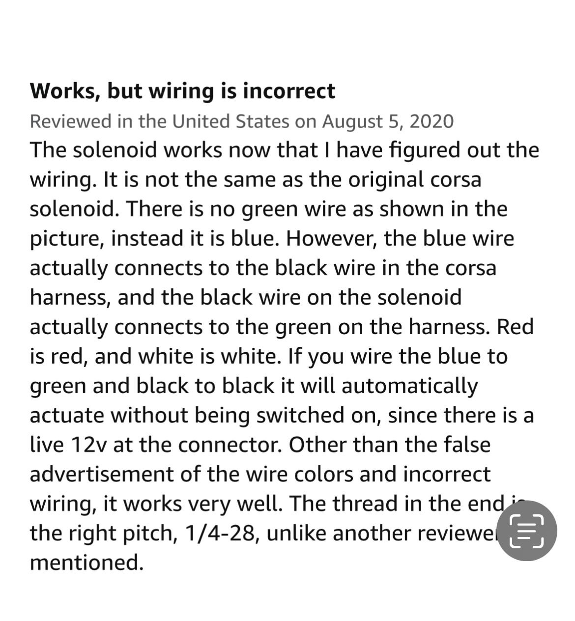

Schematic for after market actuators
