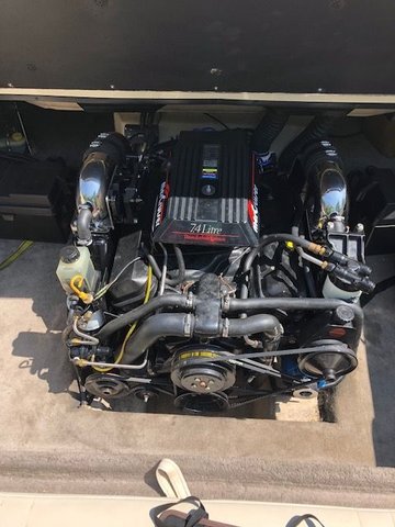

Spot on. This was my 21' Bryant.

I have about 15 inches of clearance in front of the engines. I can lay infront of the engines down in the bildge.
