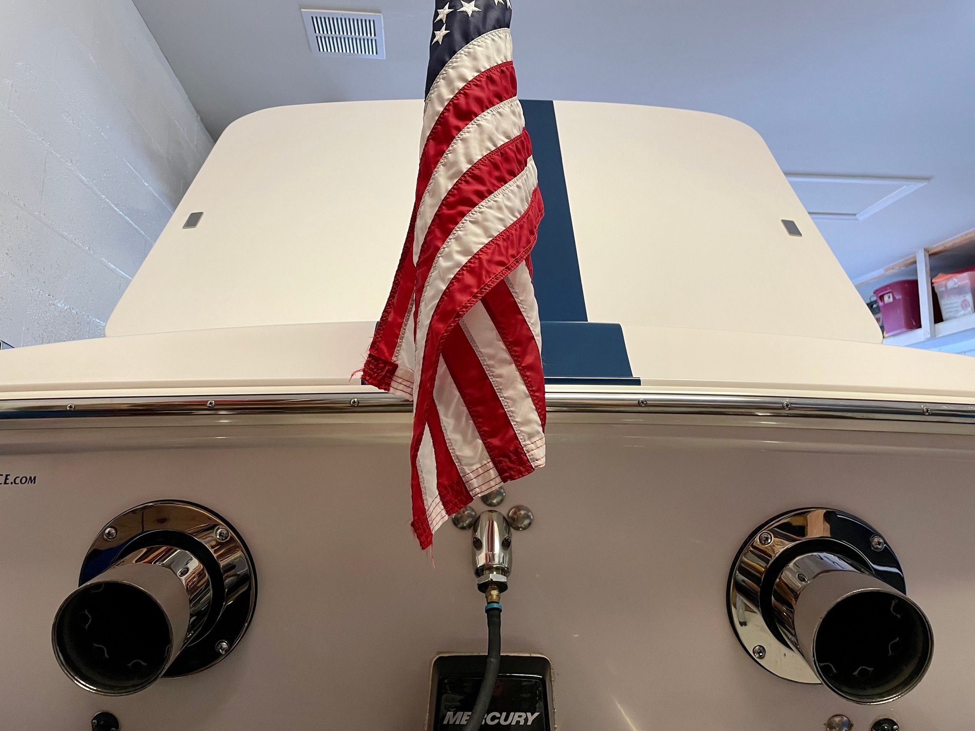

Curious so I have EMI slash tips on the boat now, I spokt to EMI and they said if I want to retain the tips I can cut the new dry tails back shorter so they are just before the tips and couple them with hose. The dry tails have no internal flaps on them and my tips do, I hate the look of the rubber flappers. Do you think it is a bad idea cutting a $2,200 set of tails to meet my tips at the transom? I figure this will give the pipe about 9" of mixture with water to muffle it a bit.
My engine builder needs to send me the cam card but he said its not crazy but you will know when idling it has a cam in it. Knowing him it will be slightly aggressive.
