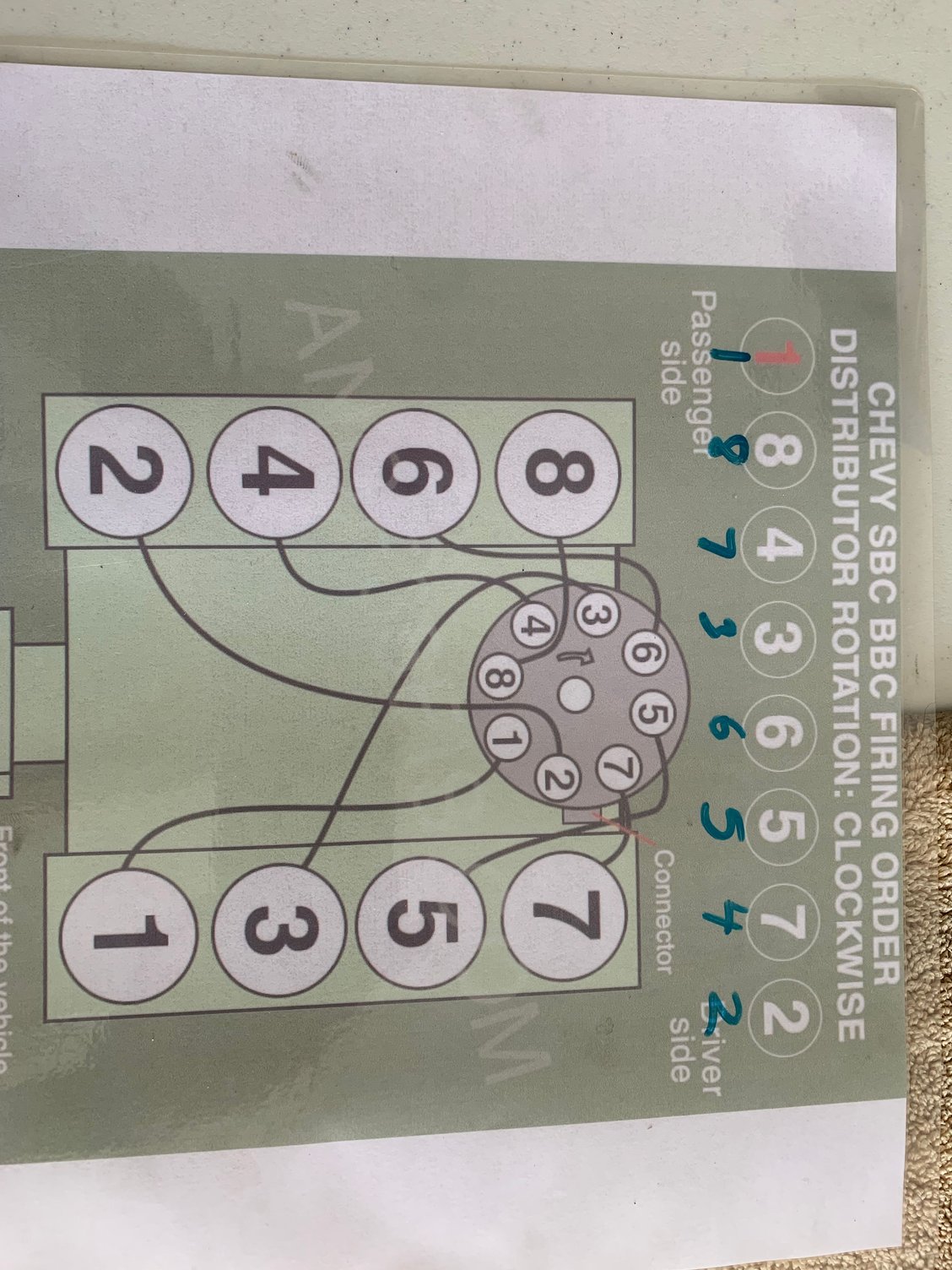

Problem solved- the firing order was changed when the engines were rebuild a few years ago. Not the standard 575 sci firing order.
Two wires were crossed.

single swap firing order
