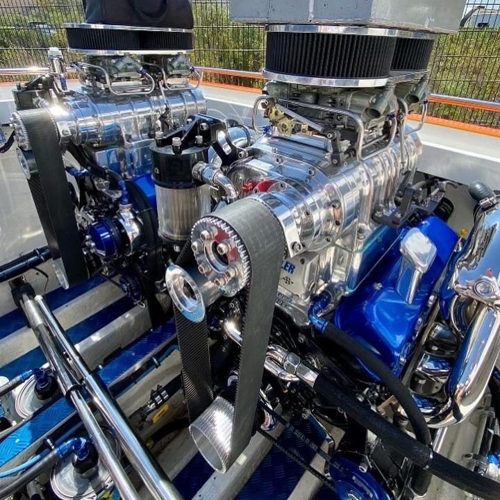

So I've been talking with a guy who is telling me to change from msd to daytona sensors he will write the tune for me to help with my idle issues when shifting into gear. What's the consensus on here about the unit. The boat runs great its just running pig rich so i don't stall it it at the docks. The boat was originally tuned and set up by john teague i quickly learned i canty operate about like he can. He can shift with the surge of the blowers and has no problem at all. Me not so good. So i took it to anthony at HP Mafia he got it to where i could at least drive it. But I want it better. So any suggestions or info would be great. Thanks for your time
Boat 38 fever Motors are blown 540s dual holley 750 double pumpers making 875hp at 7lbs of boost on 91 octane with chillers current ignition msd locked out at 32 idles around 1k and drops to 700 or so when i shift. I have a feeling they are set pretty good for these cooler temps but when it get warm tends to real rich smokes and slicks the water.
