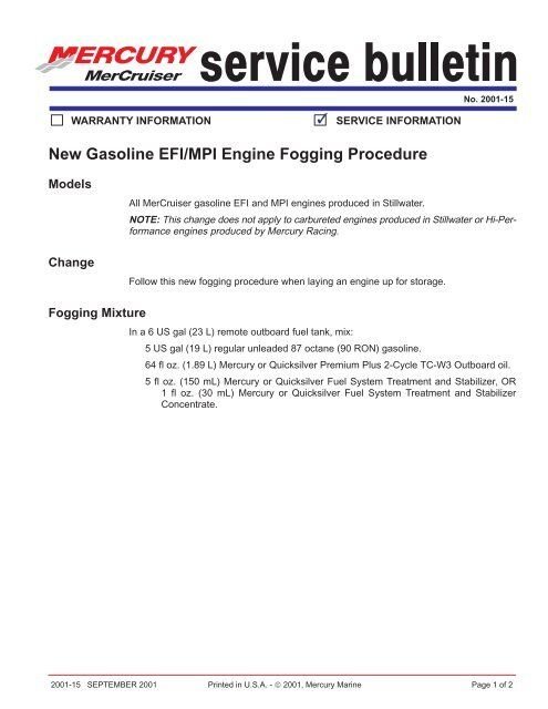

Yeah, i guess i'm giving the big hammer approach with new exhaust and new gaskets for each engine. They are 22 yrs old after all. I guess i'm unaware of just how much condensation can be in these manifolds after sitting all winter...... I was hoping my winterization process of pulling the fuel input line and rigging to suck off a gas can mixed with fuel additive and 2-stroke oil would have coated some of the components to help against the rust issue if there was condensation on it all winter. Must not have mixed it up heavy enough.
Sure would be hnice to inject fogging oil in to the intake like the carbed engines. Not sure if this motor has a MAF sensor that could get ruined if this is done. I know on my 502 mpi, there was a merc SB that said not to inject fogging spray. Had to do it the fuel pick up way. Perhaps next time, i'll dump the fuel filter and fill with my mixture as well. I didn't do that last time.

So why not fog through normal means vs pulling in a 2-stroke mixture up through the fuel pick up? What sensors can get ruined with direct fogging?
