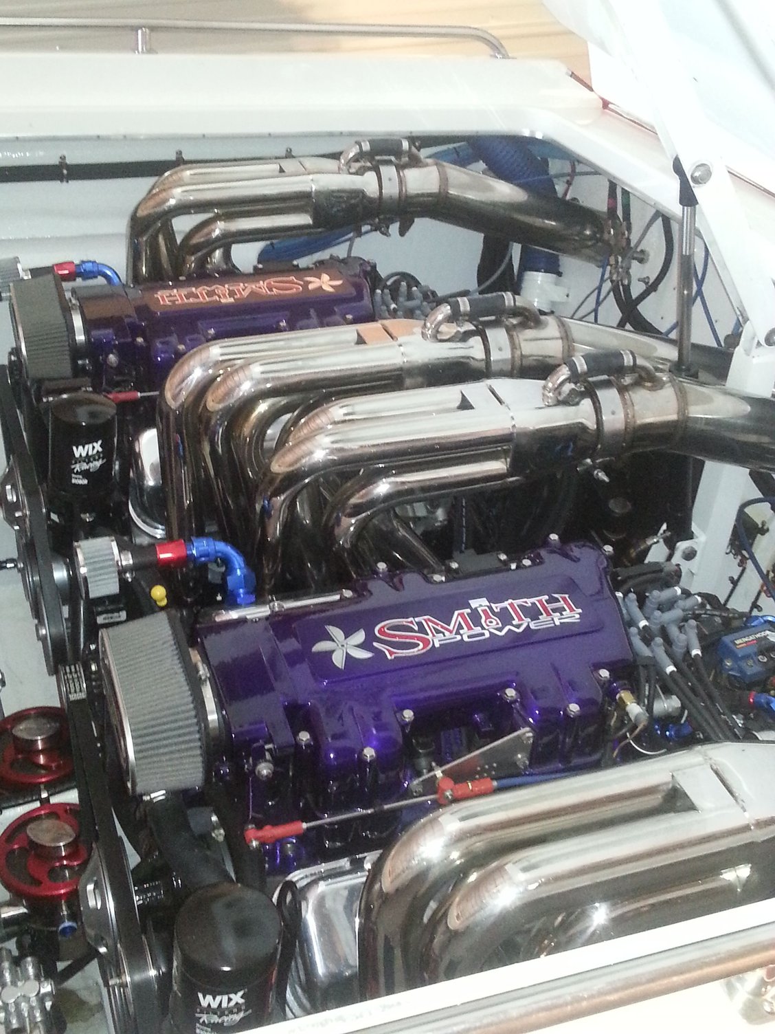

I built a pair of 540's years back with Brad Smith, custom grind double swap hyd roller custom pistons AFR 305 heads with the 500 EFI intakes, they made 625 hp on the dyno, but the intake is very restrictive, when it hits the wall it wont flow any more no matter how hard you spin it...........what is your hp goal ?
