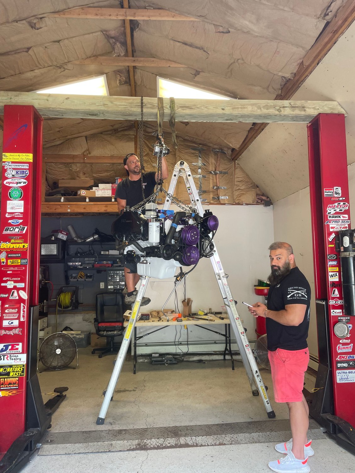

So this past weekend we installed my fresh 509 into my 96 Baja 252 and alng with this it has a brand new Bravo HP transom assembly. For 2hrs we played with alignment and it just would not come into spec the alignment tool was hitting slightly to high and off to one side. When we started to get it in the motor was just not straight and the tool bound up slightly. In the process of pulling it back out I saw the inner race of the bearing move like it was spherical. We were able to reset the engine straight on the rear mounts and now the tool slides in like BUTTER!
My question is was something off and did I wreck the bearing or does the inner race move around on a gimbal bearing? I saw no way for it to go in until this moved and you can take the tool in and out with 2 fingers now.
