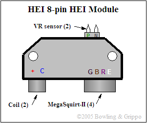

Pinouts for the EST module. You only need the coil connector (if you do not want to remove from your injection harness, the pigtail can be had on Amazon for less than $20).

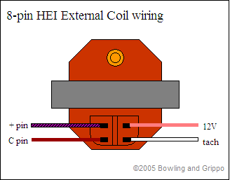

This is the factory coil connection for reference. The boat tach receives the signal from the ecm so you’ll need do a little surgery on that connector to get your tach signal connected properly. I cannot quite remember what I did on this side when I converted from the MPI. It’s not hard though.
I just did this swap last week on our Bullet using a coil similar to yours (from a TB-IV/MSD). I tied power from the harness (purple) to the positive on the coil. Red wire from the distributor to positive on the coil. Brown wire to the negative on the coil, and then the gray wire from the tach to the negative on the coil.
When it’s done, total timing is all you’ll need to worry about. 32 degrees with iron GM heads should be good. Check and adjust at 3k rpm. If your balancer isn’t marked, you’ll need a dial back light. Your MSD box may not work with some lights (honestly, I’d drop the MSD box - the EST is more than capable without it - just add a rev limiter).
Hope this helps. If you have any other questions, just ask.
