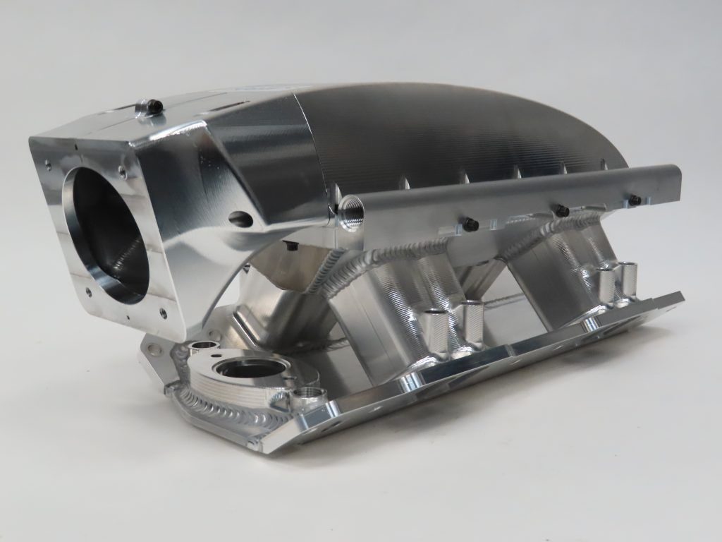

I am thinking something like this with fueltech What you think ?

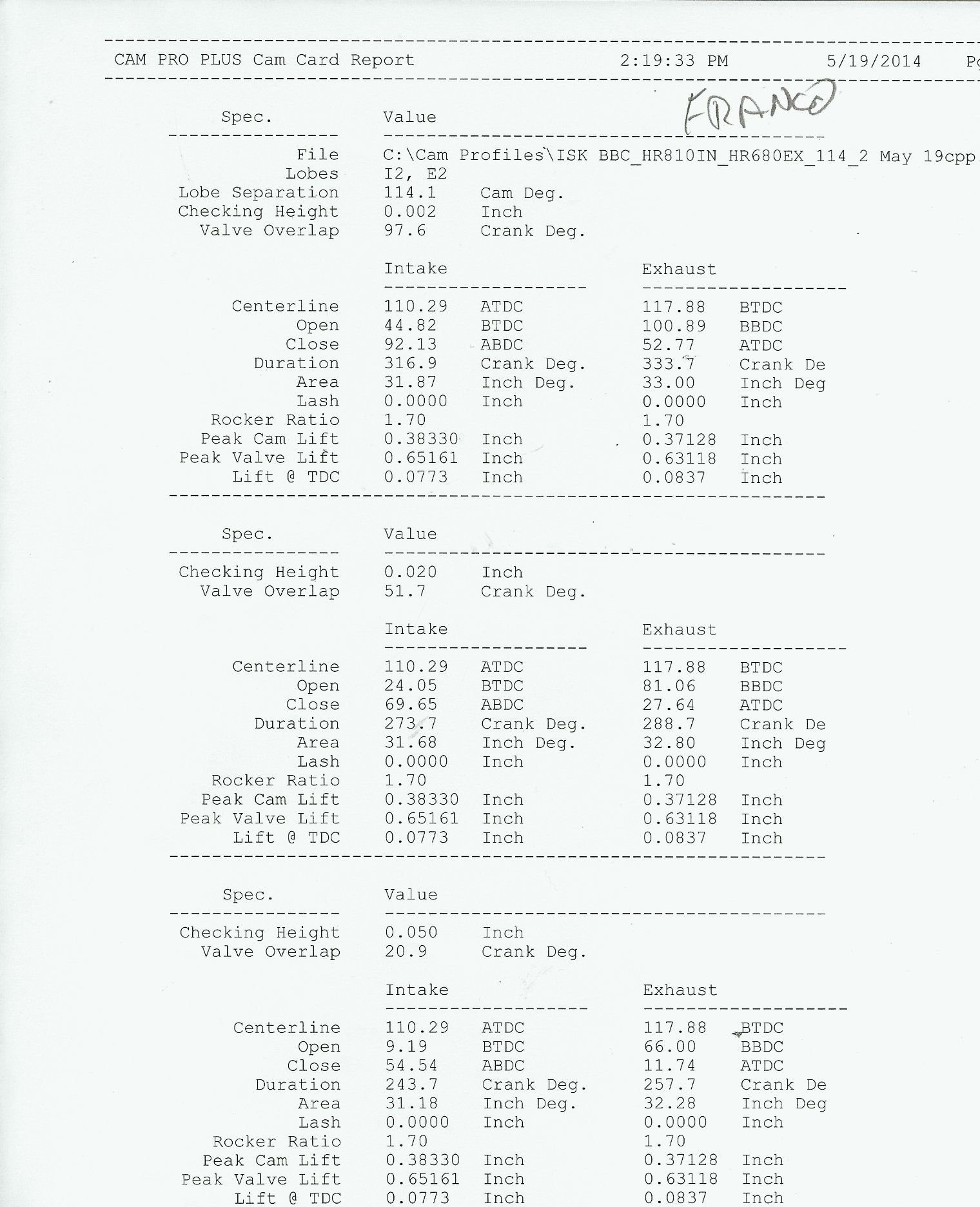

This is my motor . 572 Dart big m block merlin heads stainless marine gen 3 exhaust running full dry . Ignition system still stock with MSD coil only . Cam specs attached
Who makes that intake, your biggest issue with this particular style intake and I DO love them is thermostat housing clearance/flame arrestor clearance on a single engine. You CANNOT put a 90 degree elbow on one front of one of these NA and not kill off serious hp. Id like to see a intake like you pictured with about 2' longer runners (about 8"). I have made some OUTSTANDING hp numbers with modded Edelbrock proflow intakes/ throttle bodys that are very similar to what you pictured, did lots of flow development / dyno testing on various things bolted to the front of the throttle body with almost shocking results. Ive made HP numbers (680+) with a Edelbrock proflow ) on 509/515 engines with 89 octane BUT was hard (almost impossible) to implement in that config in a single engine boat, Smitty
