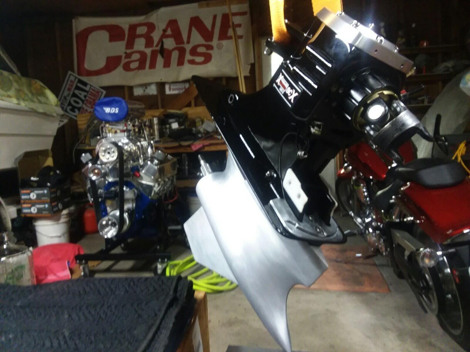

I thought about a whipple but my cr is relatively high so then it ends up with pistons plus cost is a whipple at 10k. My XR would likely grenade after a few hours and then 15-20k for an SCX. That’s the way to go though, she would be a runner. I would get a lot of boating time too after my wife left me with the kids 😂
Good call on the prop. I could use a few more RPM and have it dialed in. Out of the box B1 28p.

Honestly your XR is likely on borrowed time as it is with your HP and TQ numbers however I see your point. That's the dilemma I was in when I started upgrading and to me knowing what I know now....I would EFI swap it with ignition control, try a -2 which was mentioned in your initial post, and play with props. You will have better drivability and maybe even squeeze a couple ponies out of timing adjustments as you could be a little more aggressive with EFI and with the lower/props I wouldn't be surprised to see the couple MPH gain you are wanting. Just an opinion of a guy with a neverending project hahaha. Looking back I should have just sat down and said this is what my plan is and execute from the beginning instead of trying to patch it together enough to use it for a bit just to take longer overall. Spent way more money than I should have and have been basically boatless for a few years because of it. You have a great base to go off of from the sounds of it and now that the base engine is built and running well from the sounds of it I personally would leave it alone minus the upgrades I mentioned....EFI, lower, and props.

I was told by some reliable sources that the 29 single and 27 didn't gain anything with a shorty lower. Most cases they lost mph. I can't say this is true in all cases but it was true with a guy I know that had a 27.
