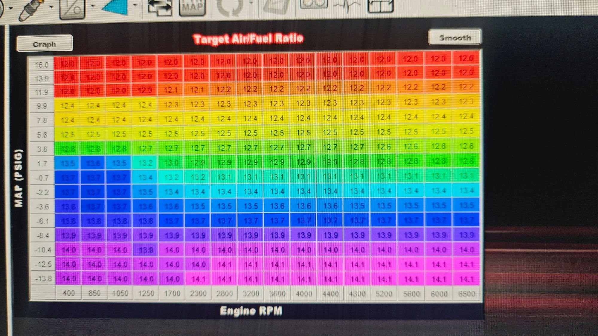

ICDEDPPL 09-08-2023 11:51 AM
Originally Posted by articfriends (Post 4879085)
so your seeing 12.0 at wot in hard boost ?
7lbs of boost yes.
I like lower 11`s myself but you ever see a 1075 on the dyno... 12.4afrs up top
Also my buddy been runing this map with low timing on a 43 Nortech with 5.0l Whipple without issues .. that would scare the crap out of me but it works for him and he does not drive it easy.:readinghelp:
