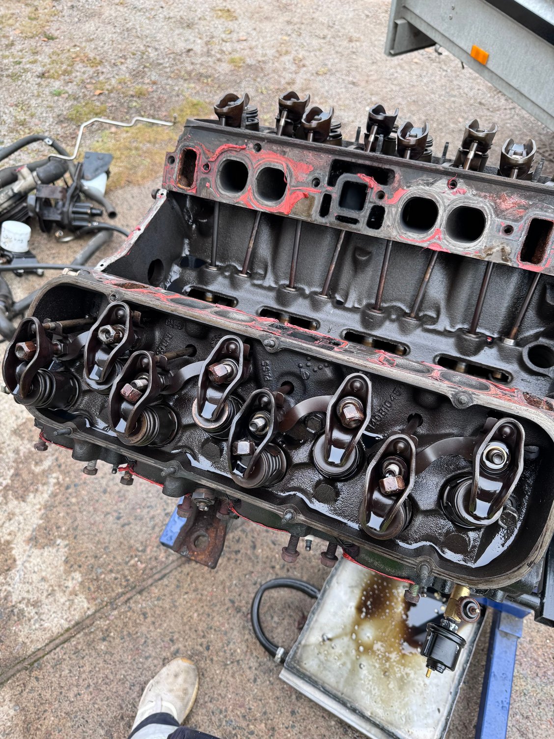

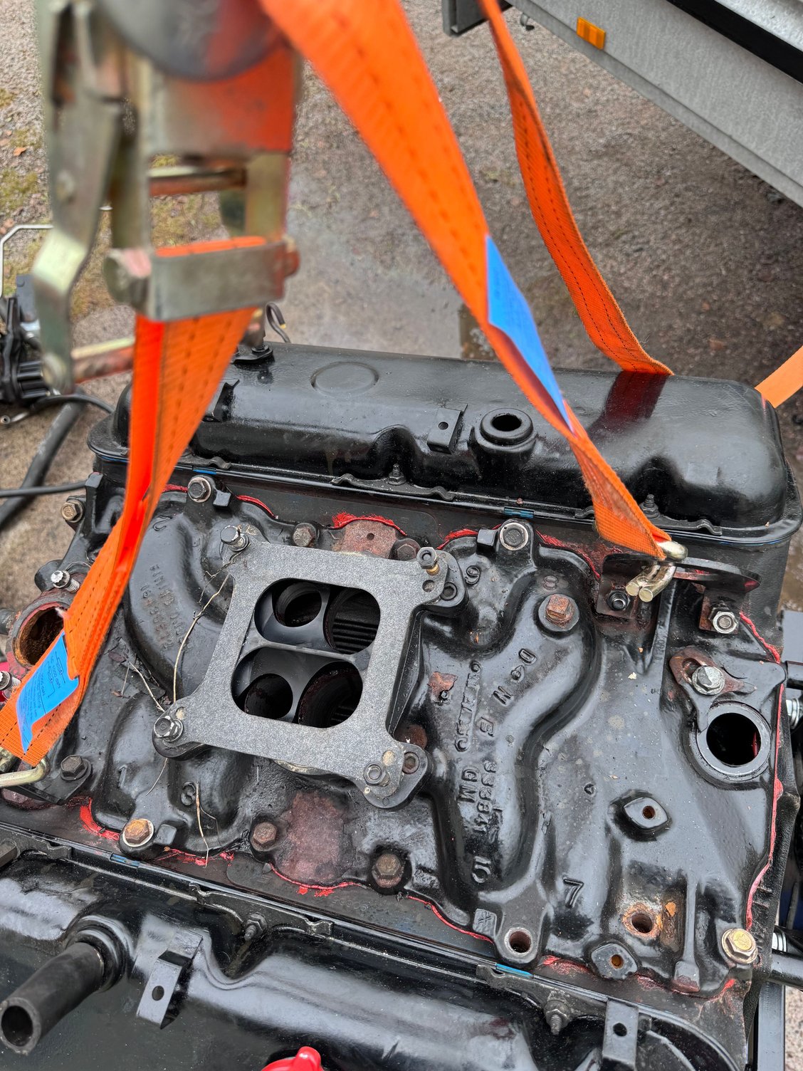

Alright. I’m back with the verdict;
jocke is offline
Old 10-04-2023 | 11:40 AM
  #55
Joined: Sep 2023
Posts: 31
From: Sweden
A 2-bolt block. Not sure what these heads are though. With this knowledge what I’m looking for changed a bit. I think only a modest build with stock exhaust is enough. If there’s any idea of doing that. Since finding someone that’s capable of a line hone is a bit harder where I live. Also feels like it’s not worth it to invest as much in a 2 bolt block

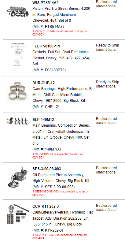

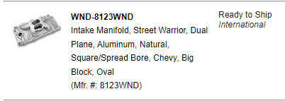

I'm back and after giving it some thought I decided to go the budget route. It'll be more of a refresher with some higher compression and a new cam than a full blown performance build. The main reason for this is because the uncertainty of the performance of my hull and because my block was a 2-bolt.
This is my order from summit:
The block is being bored as of this post and I started disassembling and sand blasting my heads. 1 out of 16 valve seals wasn't cracked. I was also planning on porting the heads to fit the oval port gasket but it seems I don't have enough material to remove that much. Anyone with any experience porting the peanut heads? I'll try to update as I go
