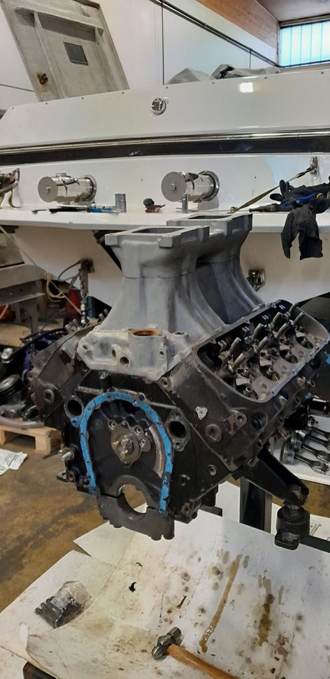

Say why and 🤣 just came from shopping. Going to weld injector bungs and convert this to efi. Wonder if 2x 1000cfm throttle bodies are too much, or should i convert the upper for single 1 barrel?
https://cimg8.ibsrv.net/gimg/www.off...e700ab5cd7.jpg
https://cimg9.ibsrv.net/gimg/www.off...f3a4eed183.jpg

Just measured the runner lenghts, head 5.5"+manifold 8"=13.5". Weiand 1985/5985 intake. Meausured head is gm iron oval, dont have the floteks home yet. floteks have a different intake valve angle, so that may vary a little compared to the gm iron head
https://cimg9.ibsrv.net/gimg/www.off...f603030e0f.jpg
