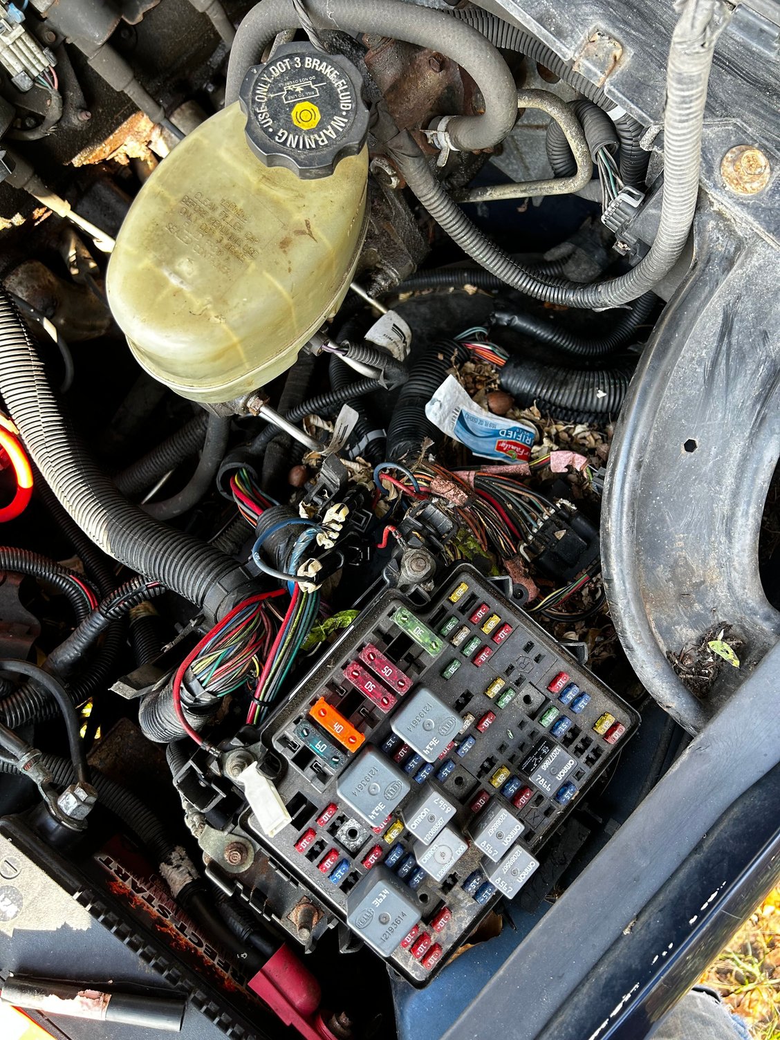

I talked to a friend today who mentioned to disconnect fuse box under hood and lift up and look 👀 for any chewed up smaller wires. Evidently he had happen from mice on a GM that sat for a bit.

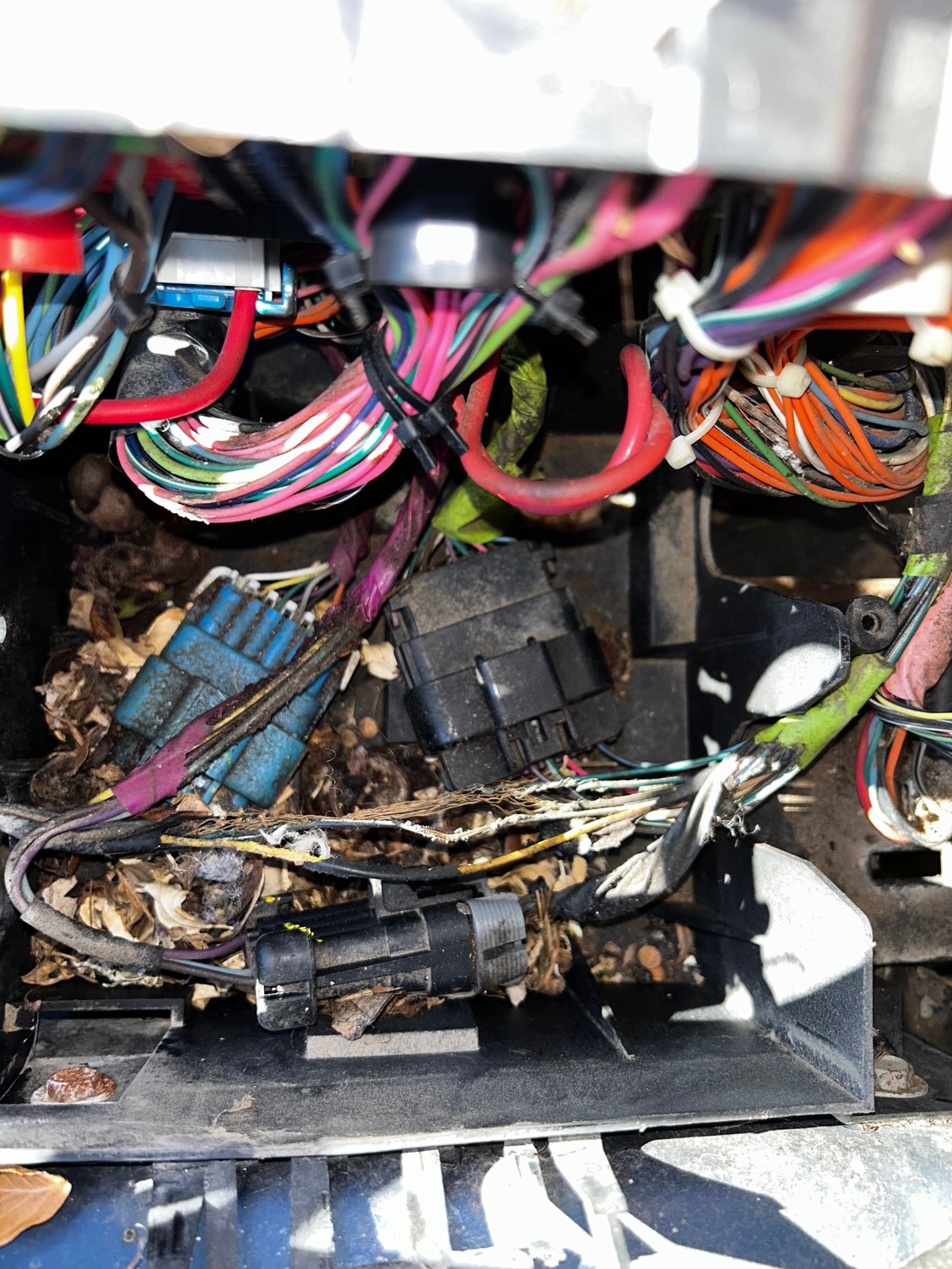

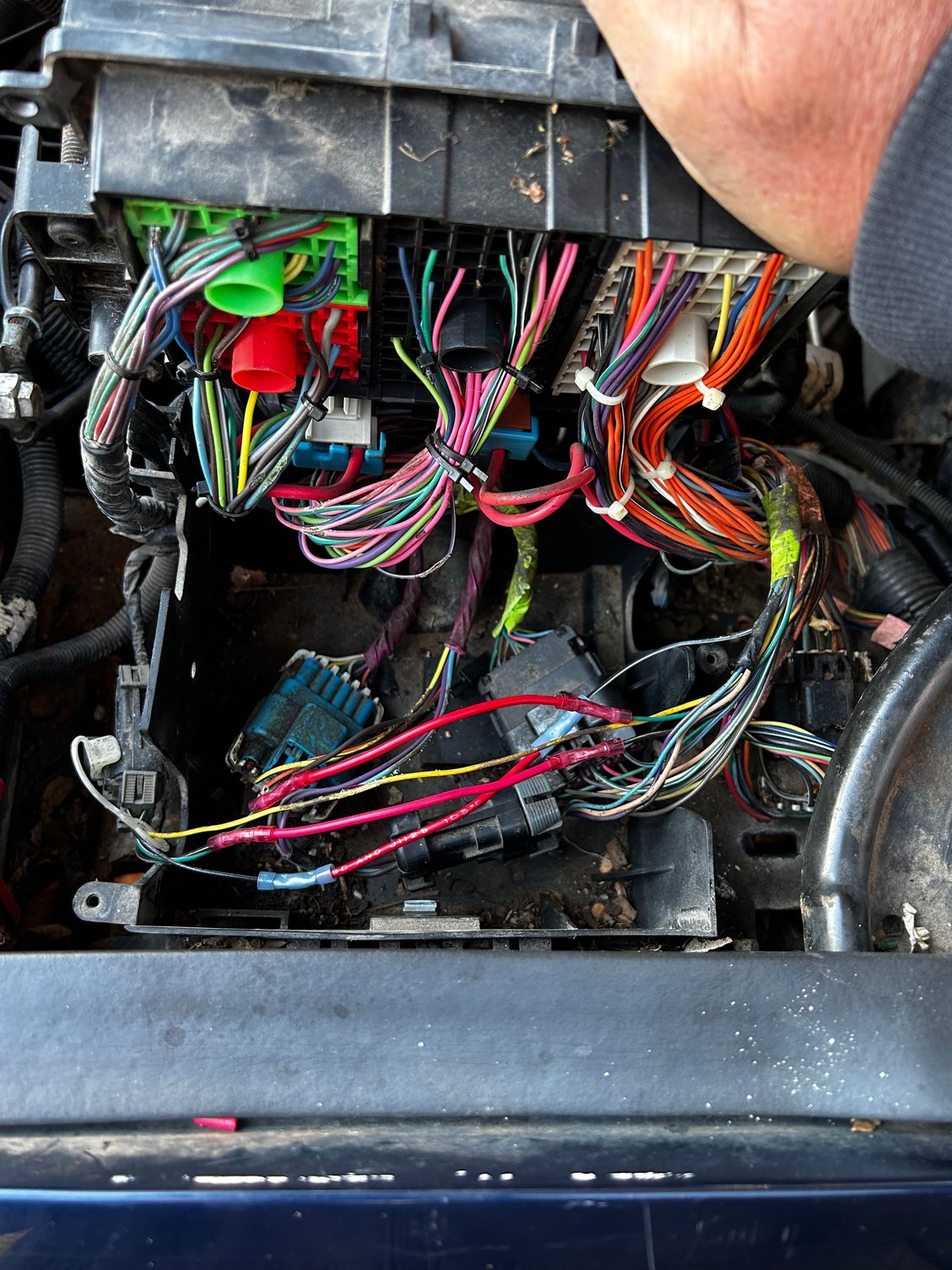

I pulled the fuse box and quickly identified a chewed off wire but wasn’t the culprit.

Unplug a easy to get to injector, get a digital 12 volt meter. Turn key to run, probe both sides of injector wire to ground, one side should show ignition voltage with your key on. If yes, this verifies they have 12 volts. Now stick both probes in injector plug and crank over, your digital volt meter should flash around 3 to 6 volts as computer attempts to fire the ground side of the injector to fire it. Judging by the mouse nest and chewed off wire in your pic, I imagine you have other bad ones you havent found yet, Smitty

Tks Smitty and will do - and yes there was a few more wires that were chewed badly so I cut out and replaced and a few more that should be cut out and replaced but still making contact etc. That was the underside of fuse box.

that is why a few posts up I said to pull that box out and look under it. for some reason I see this all the time in 2000 to about 2004-05 trucks. prior to that you rarely see it after that you rarely see it but that era the mice seem to love.
