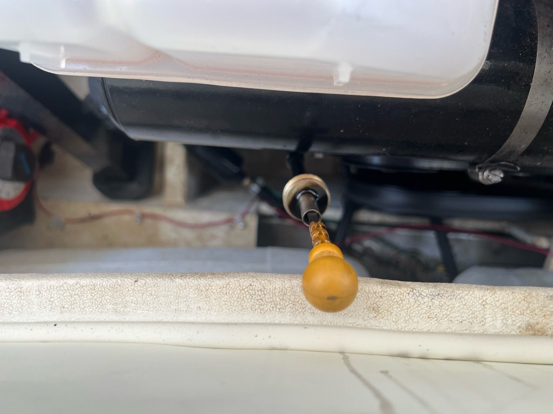

So, while all went well enough on the water, I noticed this:
No, I don't usually leave the dipstick sticking out of the top of the tube like that....
There's a small pool of oil on that upper flange of the dipstick, I've noticed it before, but always blew it off as, maybe I wiped it off the dipstick putting it back in the tube or whatever. But I wiped it clean after the oil change and it's back after running. I've also noticed a fair bit of oil on the air breather for the ProCharger, which is likely due to the end of the vent tube being secured right above it ('m going to remedy that). I've also noticed a small bit of oil loss over time, as well as the recent revelation of oil in the bilge (not a lot; just spots here and there). I have to think I'm getting some crankcase pressure that is manifesting as oil being pushed up the dipstick tube. Is this normal, or do I have an issue somewhere? Compression seemed good when going through the ordeal that ended up being the injectors, so I wouldn't think there's much blow-by.
Thanks. Brad.
