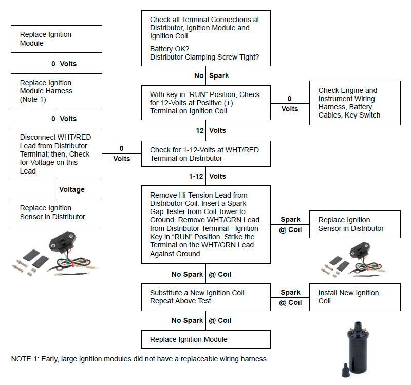

Just saw your pm, sorry, don’t ck boat sites much this time if year. It’s sledding season. Braap.
Anyway, i don’t read long things well,
did you go thru charts like this ? For testing when notvrunning, 12 volt things can be less volts. Just matters there is some. Running, things coils like 12+

Thanks for the response….. yes I did use a chart like that.
if my 11.2 volts is ok on the red/white from ignition module, then it all points to the sensor again. I just can’t believe a brand new sierra sensor would be crap out of the box.
