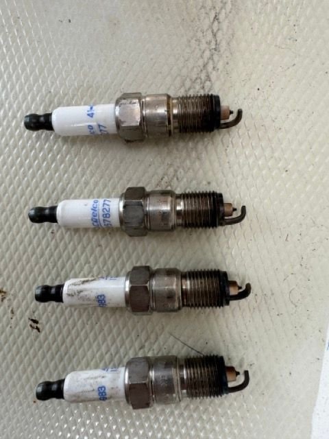

Above are the spark plugs that came out of the STBD head. Left to right, in order will correspond to fwd to aft. They all look the same actually to me except maybe the 3rd from left was a little darker.
