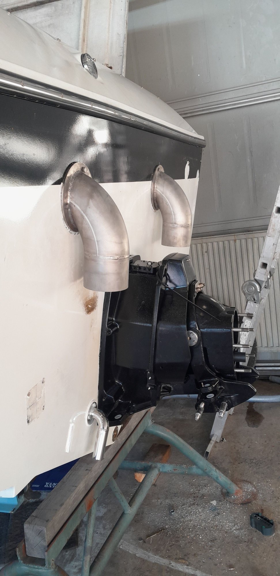

Dry to transom with 4.5" downturns. Not sure how and where exactly to enter The Water. I Would really like to hear some opinnions how to do IT. Also The collector on those cmis IS stupid large, almost 4", i Would really like to replace IT with merge/reverse Coney collector.
You have downturns outside the transom that dip in the water when idling?
If you're happy with noise dB..then dry would be better. Otherwise, right at the joint for the stainless downturns would work. Assuming the risers go through the transom?
Not sure how much benefit you would have using a megaphone collector. You basically only have a collector after the new 'header', so not a lot of restriction before it sees atmosphere. The amount of time you would be at full throttle is less than 10%.

Yes, down turn IS outside right after The transom.there IS not so much spacer For The down turn because of The stinger esim platform.

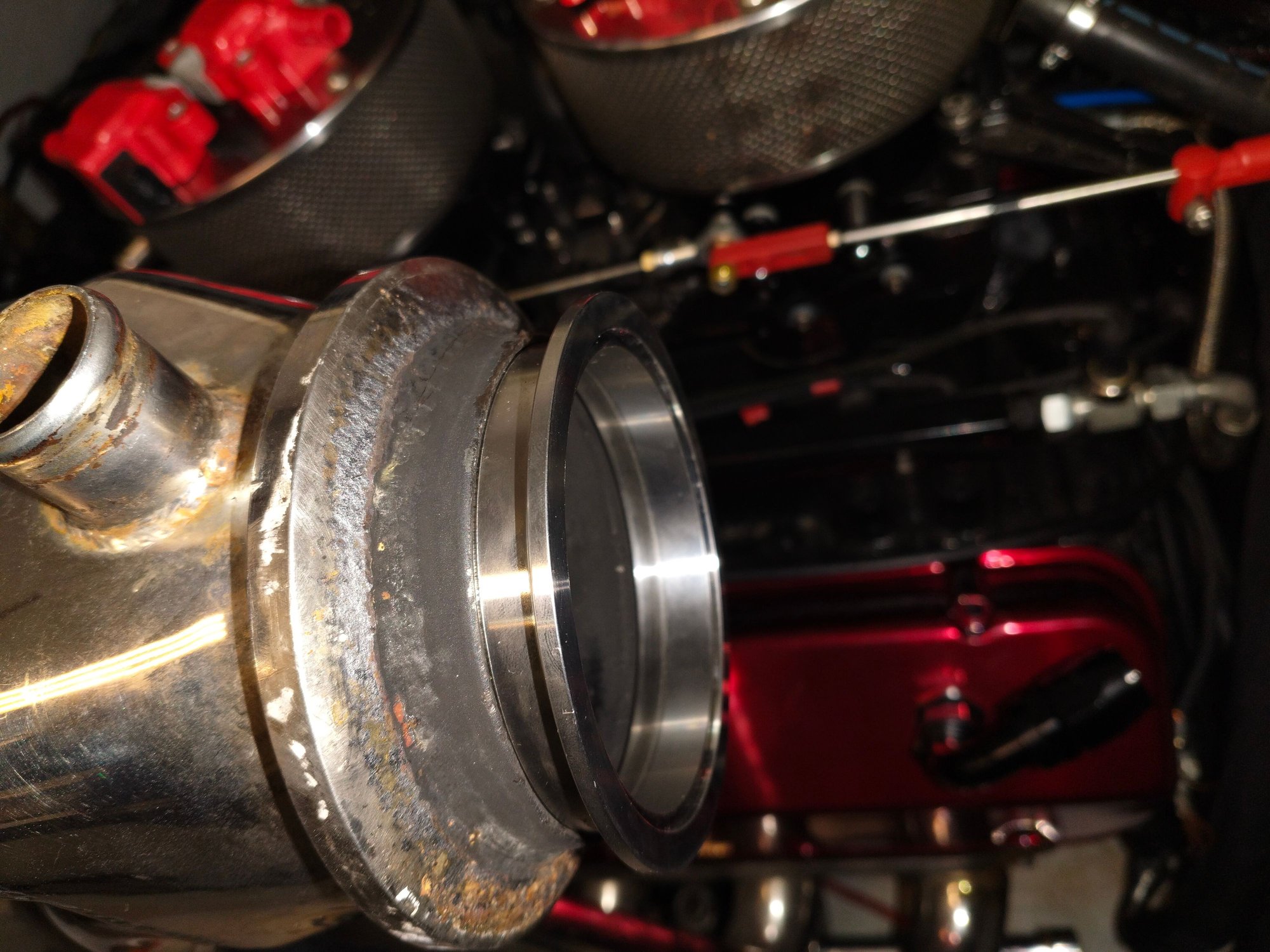

3.5" v-band flange Mock up.
https://cimg2.ibsrv.net/gimg/www.off...0a38a8cf8f.jpg
https://cimg3.ibsrv.net/gimg/www.off...ffe3aadee7.jpg
I reduces The od slightly to fitt inside The collector, and made flare inside The flange.
