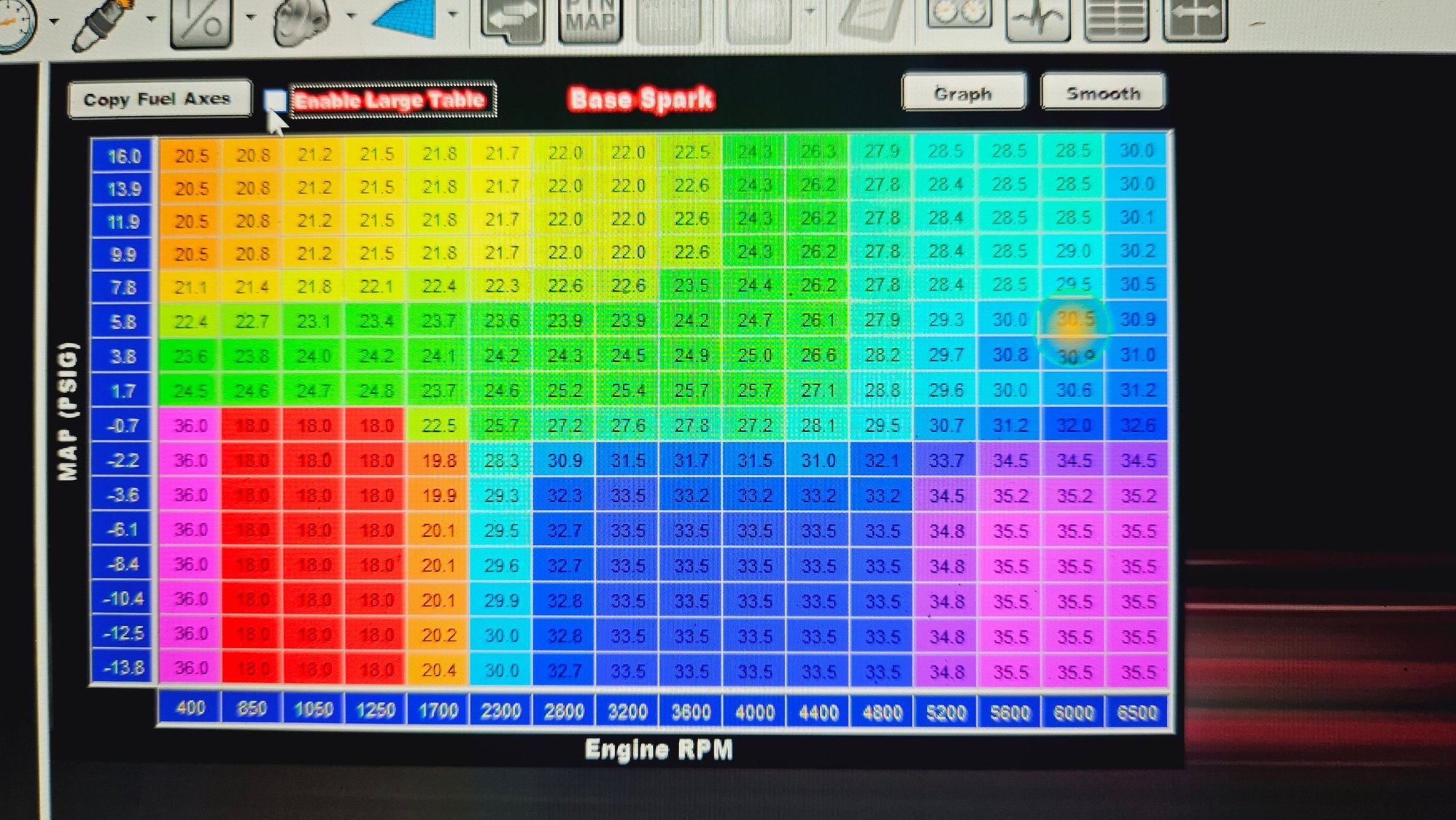

Not sure why the map isn`t more progressive. 32* anything after 3000 defeats the whole purpose of a map
I don`t have experience with NA but 32* at peak tq would be way too high for what I do.

Tartilla 07-22-2025 11:32 AM
https://cimg7.ibsrv.net/gimg/www.off...d8f257cbad.jpg
Timing isn't so much about a number vs achieving the aim of combustion with a margin of safety.
As an example in the early days of Hemi NHRA racing, they didn't understand that the massive hemi chamber need ridiculous time to burn. The guy that discovered it was winning...with something like 45° ign timing, until the secret got out.
Different chambers/piston crowns need different timing. Add in the varying exh valve temps and fuel atomization.
Dan's applications see very high air density resulting in high dynamic compression ratios. The extra cyl pressure increases flame front travel speed = less timing required + a safety margin.

madmax2 07-23-2025 03:53 PM
I ask without knowing... I find it curious to see MAP +5.8 psi in a normally aspirated engine. Is that good or bad?
Brad Christy 07-23-2025 05:24 PM
MadMax2,
I think you misunderstood Dan's comment. The table is most likely from his engine builds, which were Whippled 555s.
Thanks. Brad.
