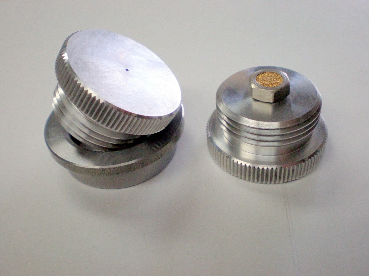

I welded some stainless fittings in and put clear tuning in as a sight glass....I have to keep it barely in the sight glass so 1-2" of fluid in it or else it pushes it out of the cap which has a small vent hole in the cap. It has a strainer/filter on the underside of the cap that I think is to keep fluid in but it clearly doesn't work hahaha

This is the cap kit I welded in
