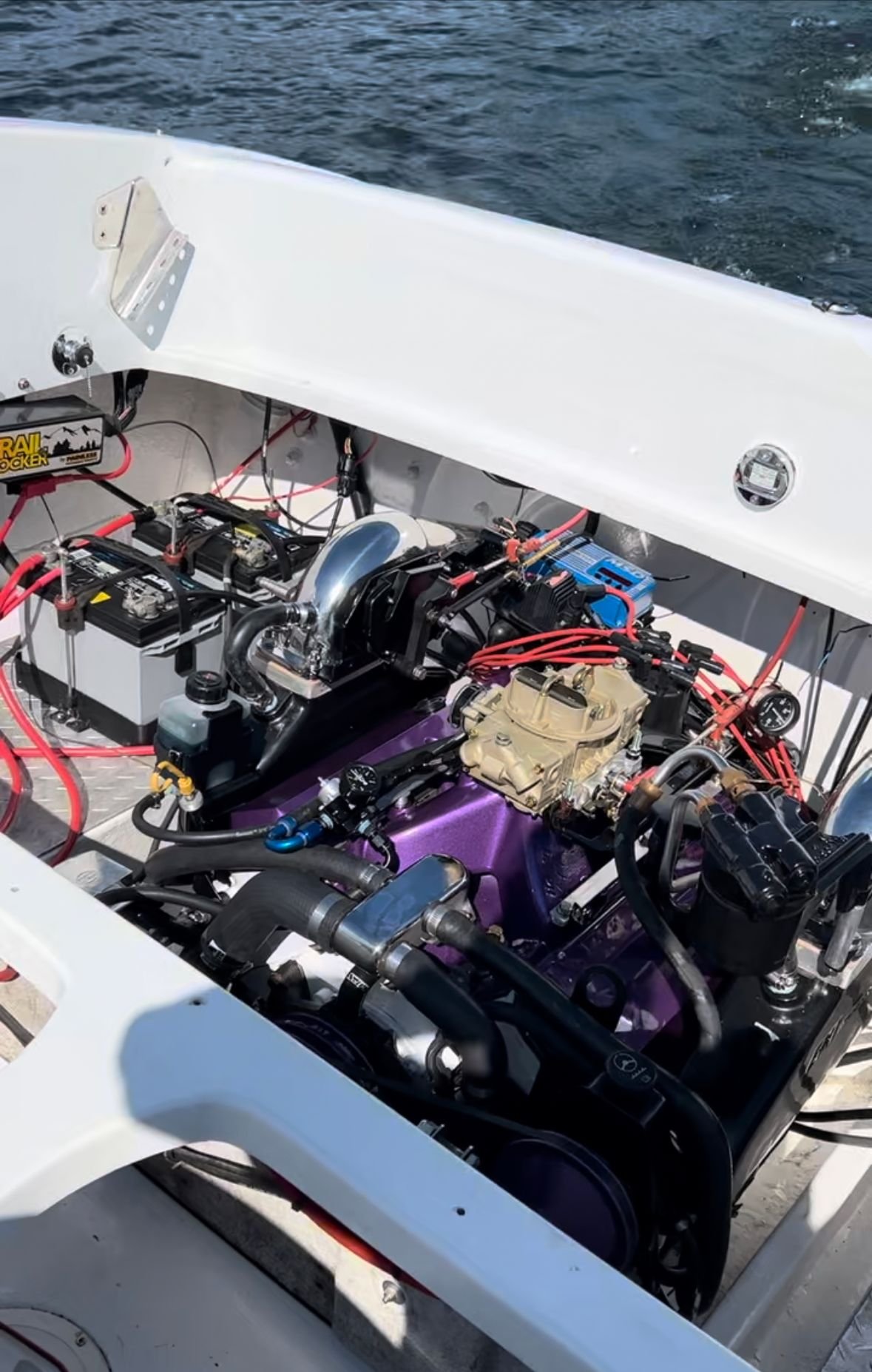

I'd be all in at 3000 or just after and total at 35 degrees. Run the tightest curve you can as long as initial isnt to high to generate hard starts. If thats the case add curve and pull base to be all in at similar point but total is more critical unless you idle or troll the bulk of your trip.
I would say my boat spends most of its runnng time between 3-3,500RPMs but I do idle around as well. WOT pulls I do run to clean it out but short blasts never for more that 30sec or so. As mentioned prior I am going to be switching over to Holley HP since I have it all sitting in boxes in my house I just want to enjoy the summer and tear into it come fall. It already has the EFI intake on it but I plugged the injector ports with aluminum injector blanks, so all I need to do is remove the carb and bolt on the 1,000CFM TB.
So I don't want to get another ignition box, I rather just let the distributer control the timing for now until i switch over to EFI. I have another distributer, ignition box, coil and fuel pressure regulator I have to swap over too as well.
I guess play it safe if you see figure D, I switch to the 2 light blue springs and the green bushing stop I can set base at 12 and a total of 35 just after 3K. Right now it has the factory 2 heavy springs and blue bushing stop.
This was taken on the first test run with the new engine so dont kill me on the not neat wire. its neatened up since then LOL
