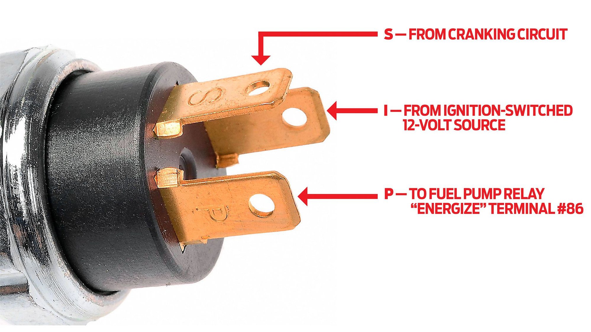

So your current oil pressure sending unit is just sending variable ground signals to the gauge. Its basically a resistor that changes value as the pressure changes. You would have to measure the output of the sending unit to see if you could wire it to a relay to trigger the fuel pump. But I'm not sure if there is enough of a ground signal for it work properly or if it will affect the gauge readings.
Ideally you would get a "T" fitting and place two sending units there (unless you have another oil port to work with) the new sending unit for the fuel pump would have 3 posts on it. And your in luck as i was just going over some of my notes here....the part number for the sending unit is
Standard Motor Parts (PN PS64)
OR Carter Fuel Systems (PN A68301)
Its a common GM part used on Vegas, Monzas and some pickup tucks from the 70;s through the 80's

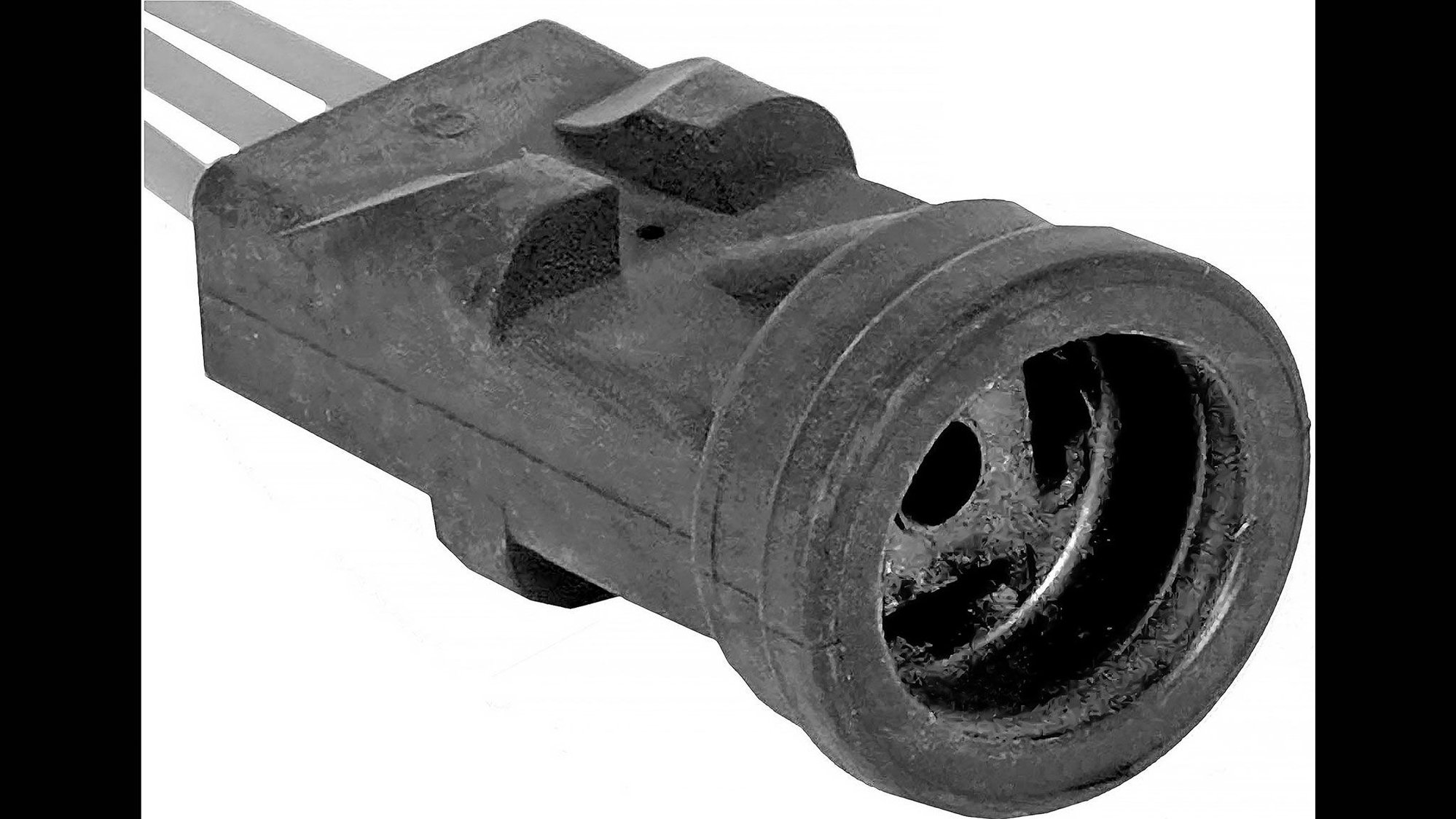

If you want the electrical contact to make it look more factory the its:
# PT139 from AC Delco
See pic above for wiring
wish i could remember where i got this from but its off the net somewhere..
