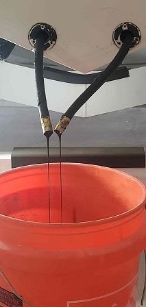

I added the oil drain tubes to each of my big boats. My jet boats didn't have enough clearance to do so.
I preferred to not have my oil drain tubes down in the bilge where I could not keep an eye on them (having an issue, loose, split, crack, leak)...
...so I had them pinned up with a carabiner on the end of the cable up near the oil filter so I always had my eye on the plug, and it was higher than the oil pan for obvious reasons.
After a day on the water, when it was time to drain the oil, I would flush the motors pull the drain tubes through the bilge drain plugs with a coat hanger when I parked it in the barn...
...and dropped the two drain hoses in a 5 gallon diesel jug; and walked away. Any floaters were suspended, and the oil was warm enough that the majority drained in a few minutes and leave it for a few days so the pans literally went completely dry.
Then the night before going back out, button everything back up, change oil filters, add oil and head out.

The cat has the engines up high and there`s room underneath so I rerouted the line , put a shut off on it and utilized a refrigerant tank.. let`s see how this works out.

The long hose ? So gravity drained , out the drain plug ?
Id prefer to do that and i have lot of room under the engine actually and all accessible. I like this.
Do it. Makes oil changes a breeze and 98% of old oil drains out
