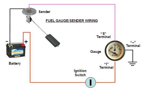

If gauge pegs to full, prob is usually on the sender (pink wire usually) wire side.
Do you have other items hooked (wired) to this gauge ?
First, I would unhook sender wire from gauge. Measure ohms from wire with key on. Then measure with engine running. Same reading ?
As a note: all fuel level Sender sends signal in ohms.

The back of the gauge will have "I" for ignition for when you turn on the key, "G" for ground black wire, and "S" for sender pink wire.
From “Hull Truth”
